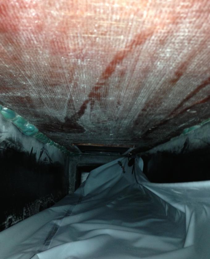

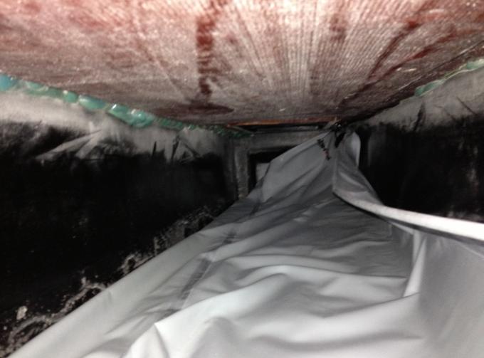

          I have a question. In the 4th picture down. (1st picture 2nd post), there looks like an overflow going into a "hard tank". Not gas that would be in the back of the boat right. What is that then? Because all the ballast is hard tank. I must be dumb. I can't think of that that is.

            They are hard tanks with soft liners. So the bag and hard tank have to be vented is my guess.
            They put the liner in so that if the hard tank cracks there are no leaks. If I remember correctly some of the early Calabria boats with the gravity feed hard tanks had this problem. The hard tanks would eventually crack and leak into the hull. Getting to and repairing those tanks was a major undertaking.

              I am glad that someone asked. I was under the impression that the 'liner' is more like its own ballast bag altogether. The smart thing to do would be to have a bag that does not pressurize the hard tank, meaning the bag is just a little smaller than the tank. That way it would never put pressure on the tank and it should remain solid without cracking. Has anyone got a picture of what you see when you remove the cover inside the rear storage? I thought I would just see a big ballast bag lying in there.

                Quite frankly, I thought the same. That if you took off the cover there would just have the fly high sacs. And I still think that until proven otherwise. The front ones, huh. I still think that the sac's hold the pressure not the bag from what I have heard. Any tie breakers?

                  Yep, that's correct. Open the covers and they are indeed Fly-High sacs. I have a picture somewhere. Let me see if I can dig it up.
                  Yeah, here you go.

                    Thanks, Jeff for the picture. That is exactly what I was expecting. Looks very well built and sturdy to me.

                      Im not following what you mean about the bow. Its also a custom flu high sac made for CC. Its a triangle shape. Its easily seen once the woofer is removed.
