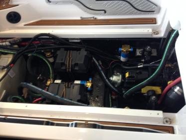

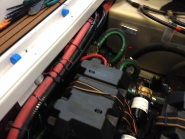

Location for starboard and center pumps

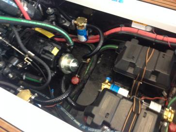

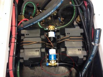

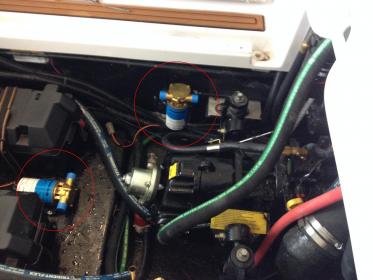

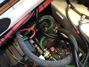

Better view of all 3 pumps. Port pump on top, center pump between the batteries, and starboard pump on bottom.

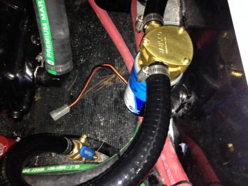

New center pump in relation to stock belly pump.

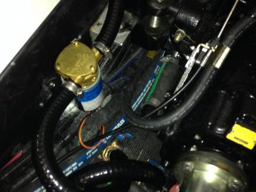

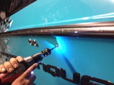

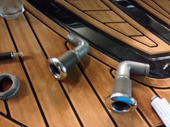

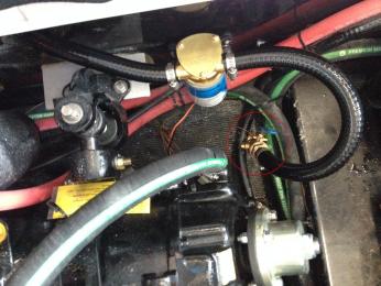

Port pump and thru hull. We used the same thru-hulls that Nautique uses instead of the plastic ones that come with the Super Sac'r package.

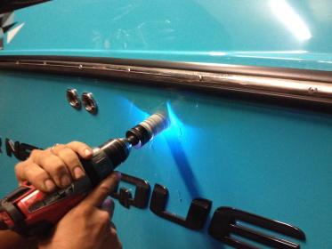

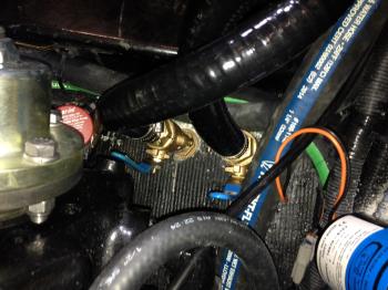

Center and starboard thru-hulls went on the starboard side of the vdrive.

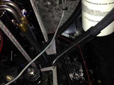

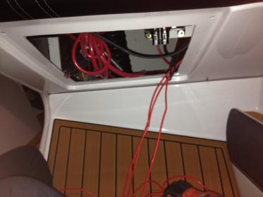

Port ballast line ran by the engine mount on the inside of the engine compartment.
Here is the port ballast line at the transom of the boat.
And the same on the starboard side.

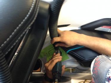

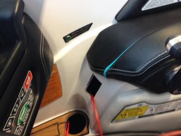

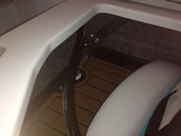

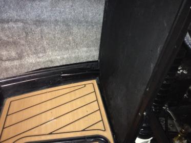

The center ballast line is ran up on the port side of the boat behind the flip up passenger seat.
Same line was zip tied neatly up against existing hoses.
