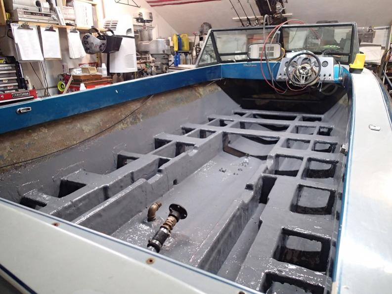

                #22

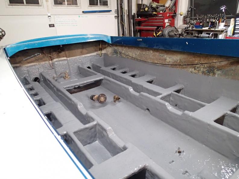

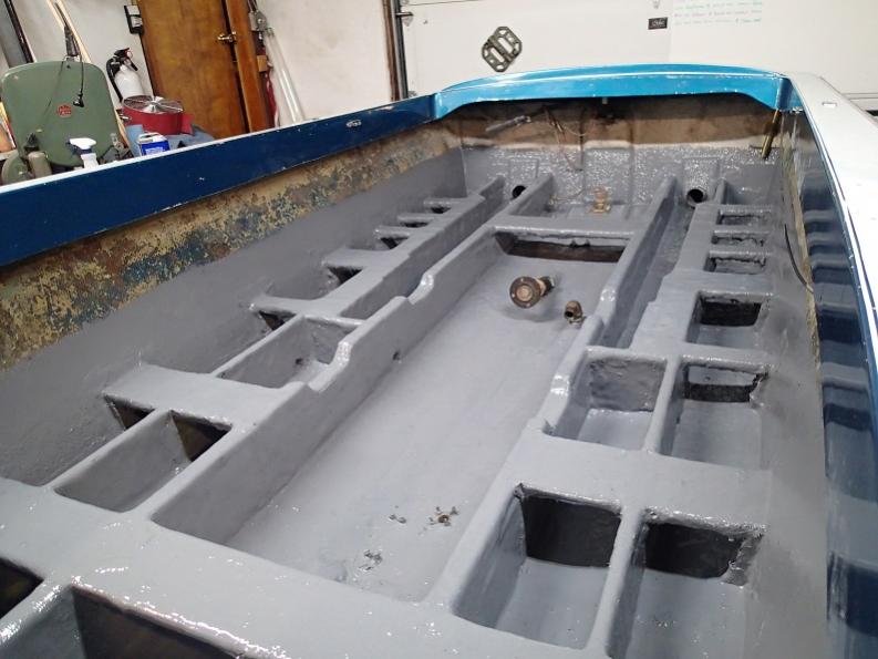

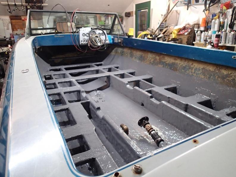

                After 10 days of glass & paint I can finally say the stringers are DONE. With the structure finished it's time to start re-installing all the interior mechanical components.

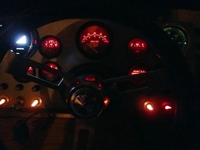

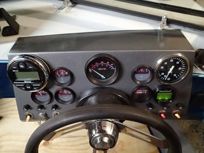

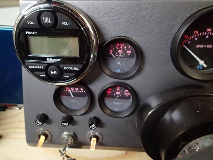

                    Although I've gotten a ton of work done over the past few months but I'm keeping most of it under wraps until sections are completely finished. I just wrapped up the dash wiring last night. It's so sweet to see it start to come to life. The dash features a new JBL radio, aftermarket speedo, digital depth finder and red gauges taken from my 83 parts Nautique.
                    Next on the to-do list is the interior / floor, heater installation & exterior air brushing.

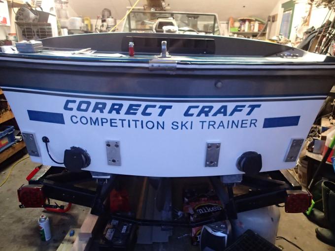

                      #25

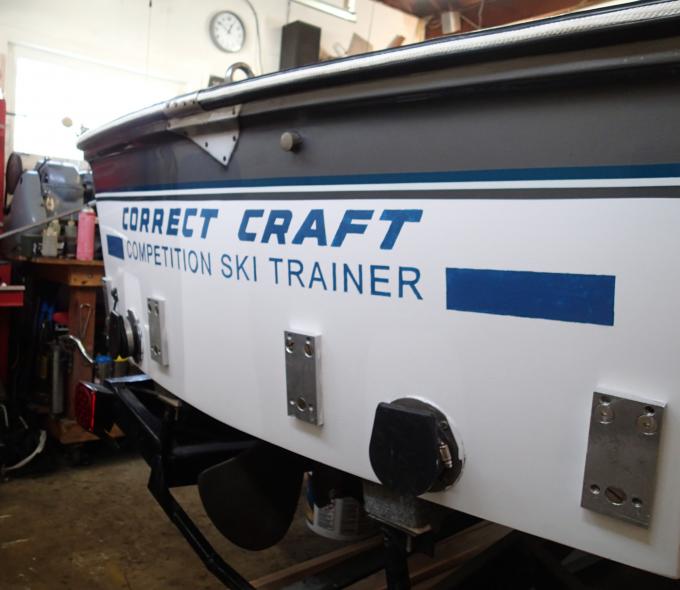

                      Getting closer: Thanks to My brother and his friend the Tique is starting to look like a Correct Craft again. Hand painted, just like it was in '79.

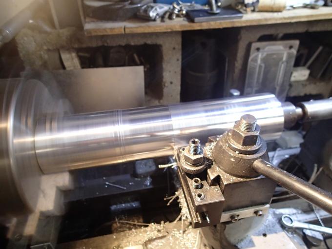

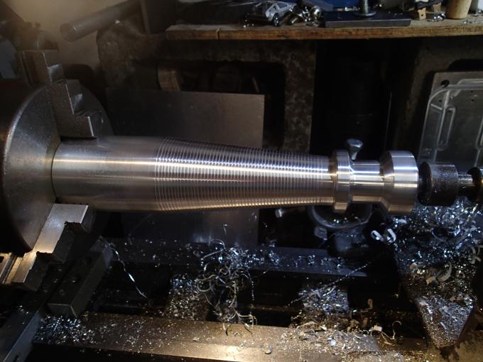

                        #26

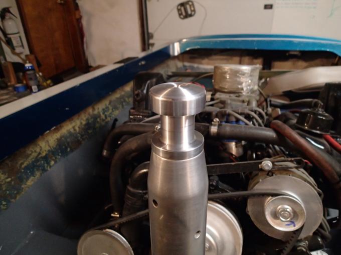

                        Pylon top & extended pylon top machining. The larger pylon head will be mounted on a tube that slides over the existing pylon adding 12-18" of height clearing the back seat & engine cover better. Plus it'll make around-the-boat tricks easier.

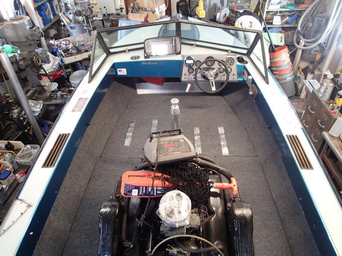

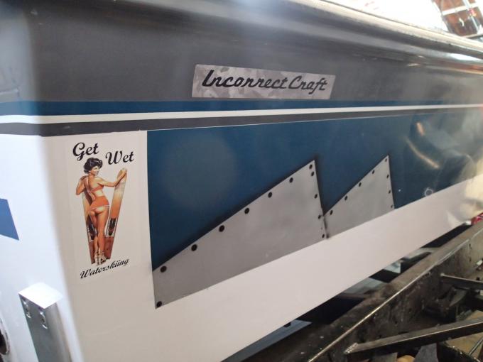

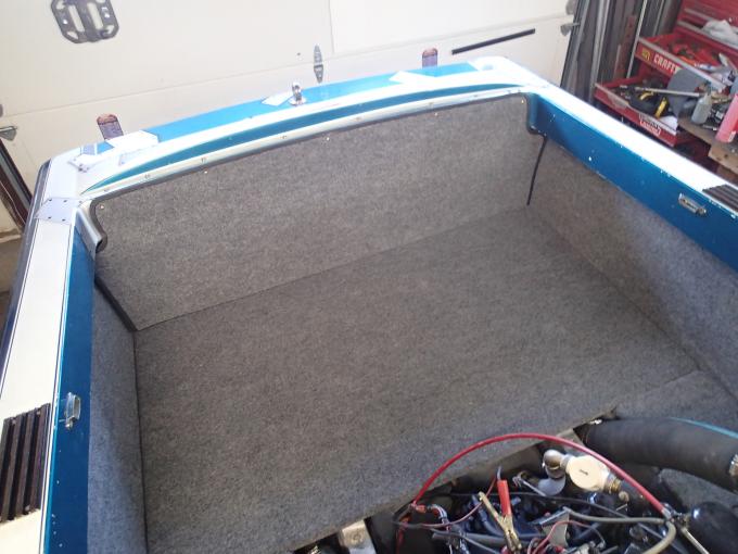

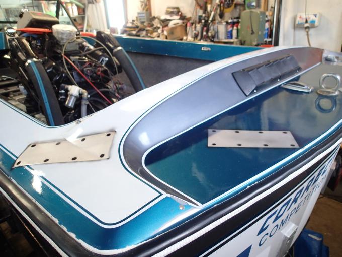

                          Getting there: Got the interior 95% finished as well as the airbrushing. You see somebody decided to "paint" the boat along the way instead of gel-coating it. The paint itself was in decent shape except a few gouges here and there. Instead of stripping off the paint and gel-coating it I decided to have a little fun and airbrush on metal panels on a coverups. It fits the whole rat-rod boat them and was a cheap and easy way to get the boat looking better. Plus if anyone scratches the boat in the future I'll just paint on another panel.
                          • LFEngineering
                            • Aug 2014
                            • 45
                            • Western Mass
                            • Rat Rod '79 Ski Tique
                            #28

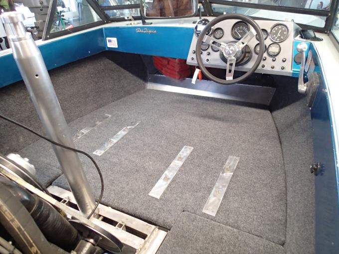

                            The interior went in pretty easily. Can't wait for the snow to melt so I can try it out on the water.

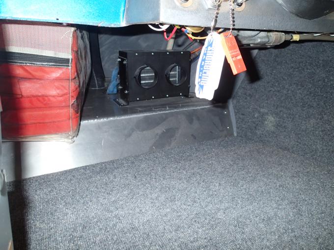

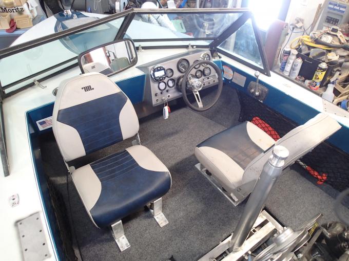

                              #29

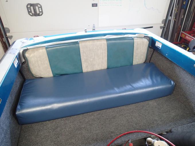

                              Fishing boat seats? They sure are. The seats came with the boat and were in good shape so I figured why not and put them in, she's a rat-rod remember. Not to shoot myself in the foot I saved the original seats / brackets in case I want to have them reupholstered in the future. As for the rear seat it's a temporary fix. I had a local vinyl shop whip up the cover for $60 bucks and I used the existing back pad. Someday I'll get a matching interior.
                              To maximize the ski season here in New England I opted to install a summit racing heater under the dash. Happy driver - happy skiers. Plus it'll help knock off that late October frost come fall.
