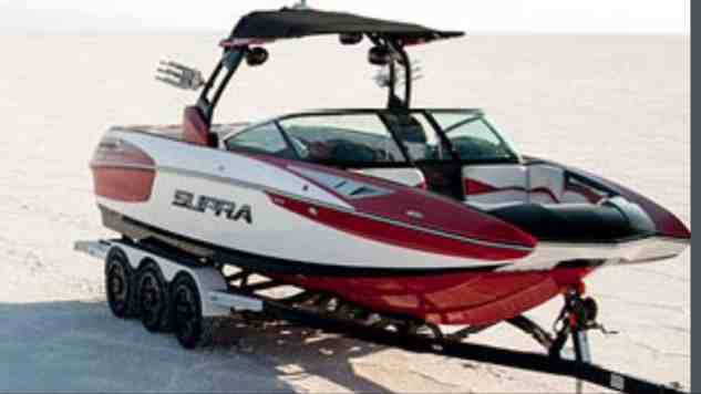

    Or I mean the Supra SE550 /SE450, my bad.

      "holy knockoff, batman!"

        Hull looks more like a Malibu to me. Need to see the back end. Tower definitely G like.

          Gotta be photoshopped

            Well the good news is that it doesn't have the c stripe on the side like nautique, Malibu, and mb

                    I can't help but laugh at these trailers. Anyone who thinks you need a triple axle trailer for these boats is insane. The 'look at me' factor of these wake boats is way over the top. It's getting out of hand.

                      Brennan, I dont think you know what you are talking about. Let me help you understand as I just went through this.
                      Here are the facts:
                      1. The majority of the G trailers are built on 5-6" tube frames.... rated at 8000-8200lbs combined, boat and trailer. The majority of Gs weigh between 8-9000lbs on the trailer. Mine weighed almost 9k. So at a minimum, most Gs on the 2 axle trailers are RIGHT at their limit when loaded for the lake, or a good majority being OVER their limit.
                      2. OK- so what if the 2 axle is over its limit by a 500-1000lbs? Whats the big deal? Trailer flex, brakes, suspension and tire wear. Excessive trailer flex can cause the winch to come out of gear, fail and release. Compensate for that and go real tight on the winch and you will snap your winch strap. Brakes are severely affected as you go north of the spec'd weight. Not to mention tire wear... most trailers are spec'd for camber to give you an even wear pattern on the tires at 90% of the spec'd weight... at 100-120% you are eating your tires up on the inside treads from overloading the trailer. Also you are running your tires at 90% of their weight carrying capacity all the time.
                      3. 3 axel trailers as see above, most come with an 8" tube frame spec'd to a combined weight of 10,000lb range for about 300lbs of extra weight for the bigger tubes and extra axle. Almost ZERO trailer flex. Running the combined max load at 90% of the trailer capacity vs over?...much better idea. Tires are running at 40%? of their capcity, less tongue weight on the truck. Braking improved significantly.... not just a little, as in night and day better. Much more stable tow, less kick back over bumps at speed as the suspension isnt maxed and articulating as much for the 6" tube frame. Night and day difference, expecially when towing a 9k ish load with a 1/2ton truck. Also, other benfits, such and less worry about dropping your trailer off the end of the ramp, I have almost 2ft more I can back in till that front axle would drop off, I have a very short shallow ramp and I am sure my back tire hangs off the ramp when I am backed in. Also, my 2 axle used to drag when hitting dips and bumps from being maxed out, 3 axle hasnt touched yet, especially when manevering throug a small dip into my side yard.
                      So for 2-3k more to have a 100% solid tow, and be within compliance, for someone who does a lot of towing its a no brainer IMO. If I lived on a lake and didnt tow much it wouldnt matter, or owned a 3-4000lb ski boat I wouldnt understand it either.
