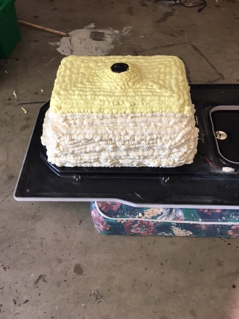

    Got a little advice from the Swankster and did this deal.... I had the floor out anyway so what the heck!! Ended up using 4 cans and put floor back in while its was somewhat soft. My luck is it will probably squeak like crazy!!!

                30 bucks and a couple hours work well worth it. I like making things better even if it was 100k plus boat. I know this much I dont have a cooler in the middle of the floor and itsworking pretty good!! Had ice in still today about 24 hours later.... its not a 100 degrees out yet but I would assume it works as good as any igloo type cooler. I still haven't decided on weather striping but all in all pretty dang happy I did it. Thanks Swankster for talkin me into it!

                      We did the same thing on my brother's 2007 SV-211. The cooler is over on the side under the cushion behind the driver. There was no insulation around it at all and the engine heat would melt all the ice out in no time. We filled in all around and under it with foam insulation. It made a HUGE difference.
                      -Charles
