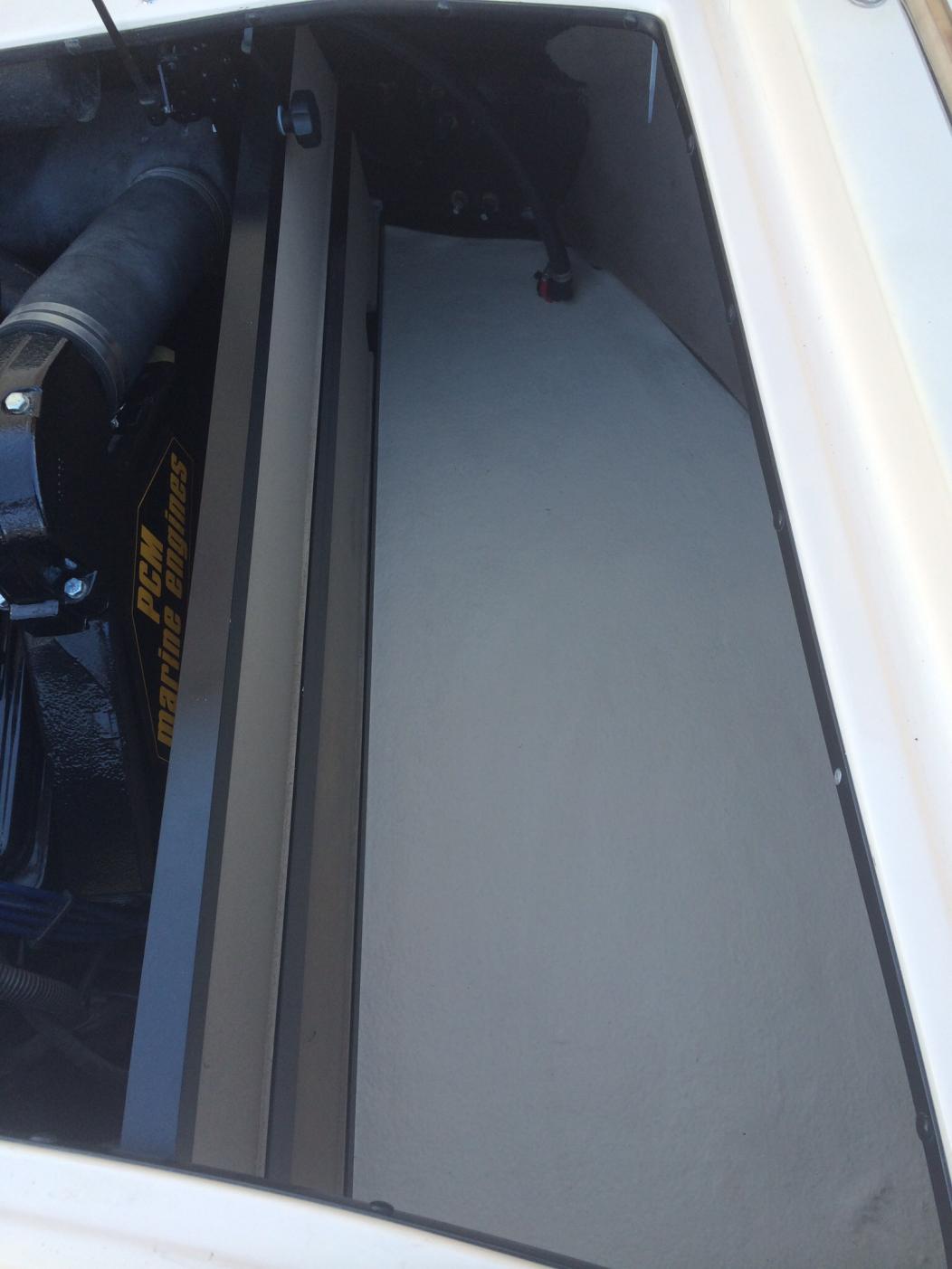

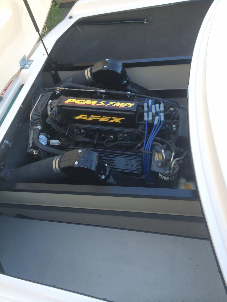

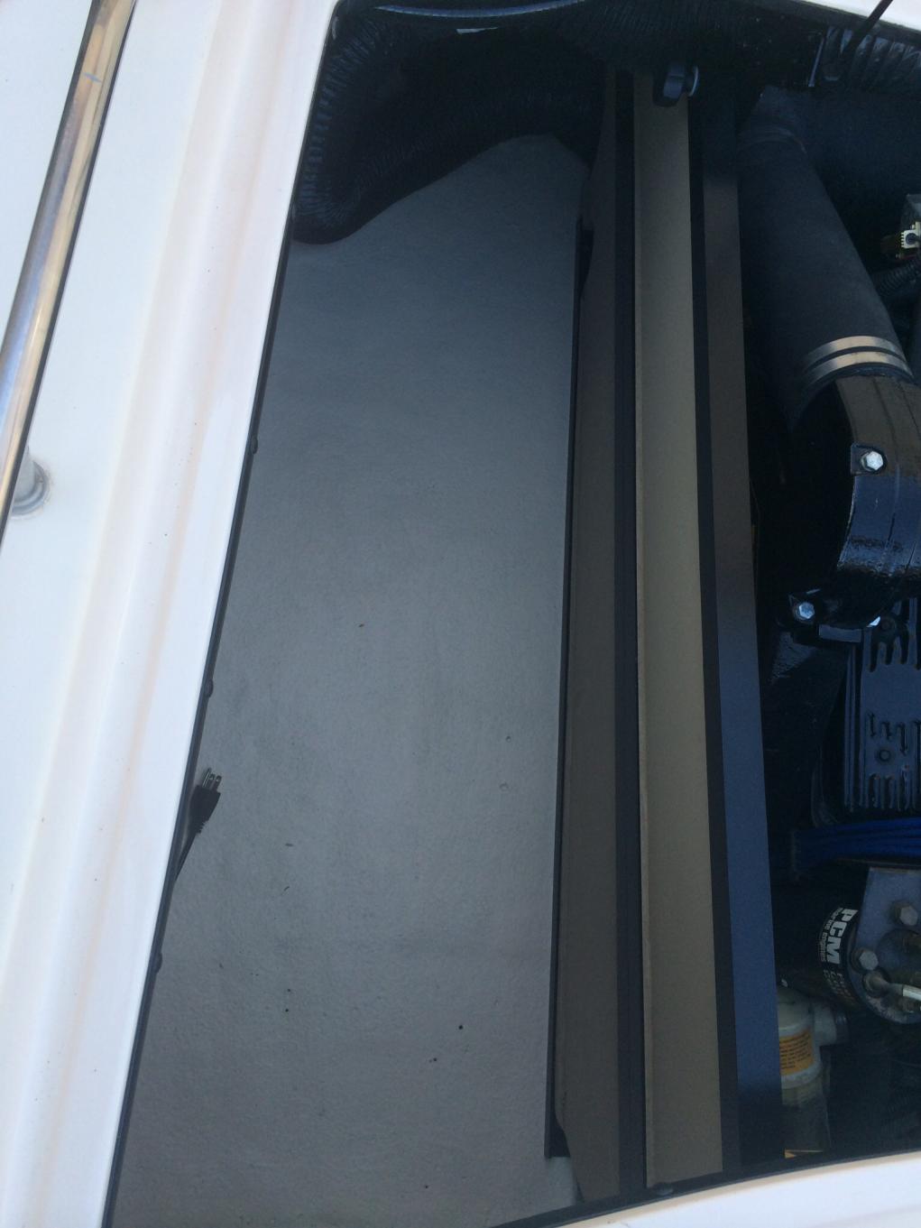

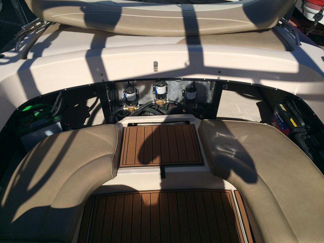

                    I have modified my dividers pretty extensively. And I have replaced the actuator in the starboard locker with shocks. But here are a few pics that depict how the dividers bolt in and the room created by removing the actuator. A 750 lb. sac fits in there easily with the actuator gone. The bolts at the back of the lockers are covered with 5/16" rubber vacuum caps.
