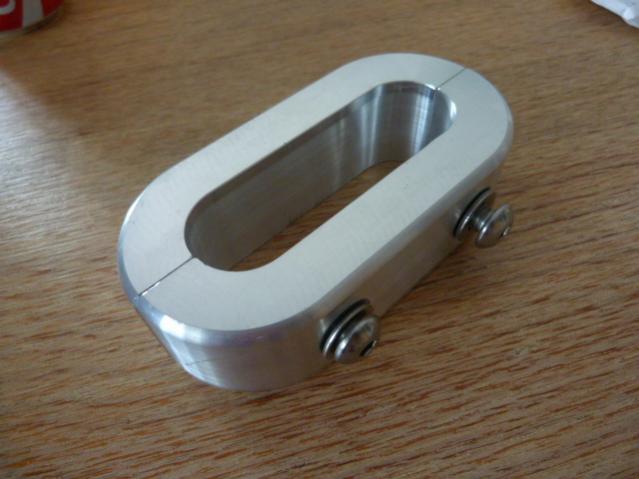

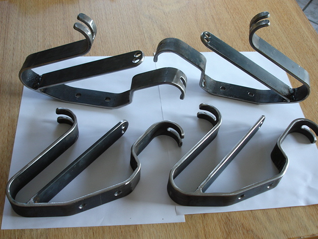

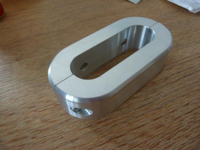

                    Flight Clips
Name:	Flight Clips 002.jpg
ID:	368672Click image for larger version
Name:	Flight Clips 001.jpg
ID:	368673 I made my own clips..just measured out and a friend made the clamps on a CNC machine... The racks I formed by hand with a few tools I made in the garage.I made racks for two boats with a material cost of about 200 euros
