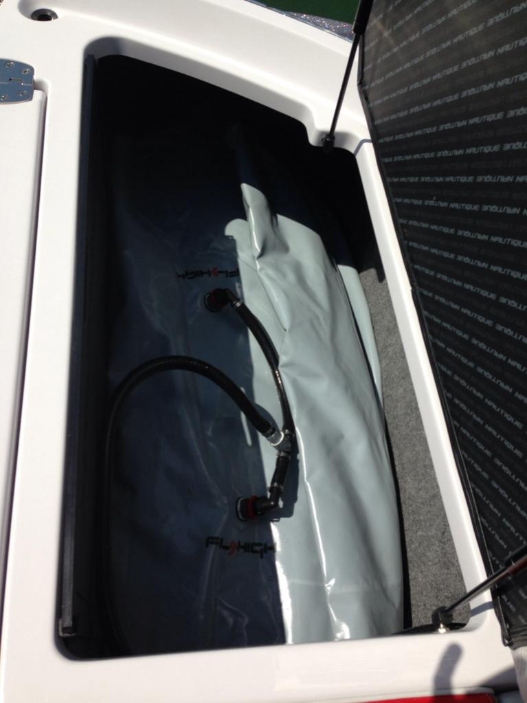

In order to get that 1000 lbs my dealer has made a few recommendations however it is clear they haven't done a lot of them so I am worried.
2 800 lbs fat sacks rear
2 400 lbs fat sacks in the side compartments
and nothing in the front
dealer has a suggested that I run a system on these fat sacks where you just throw the pump on the side of the boat. I prefer the system on my centurion where the added fat sacks are set up to automatically fill
What are your thoughts on how to do this.
Do you have any suggestions on what type of fat sacks to buy, what pumps fill up the quickest and how to install it
Call Blanton at Buxton... He plumbed mine..
Do 1100s off Y valves off the 2 rear factory pumps... And buy 2-300lbs of pop lead bags for underneath the front seats. Done cheapest, cleanest and a world class wake.2019 G23 450

I basically have a very similar setup to Ryan's, and my wave is similar. I use lead for the extra weight though. Got 600 pounds in the back compartments and 400 pounds up front.
