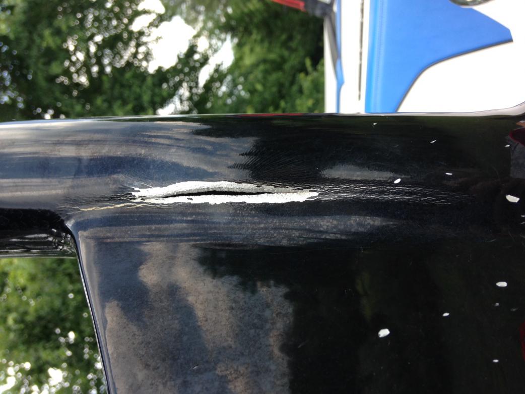

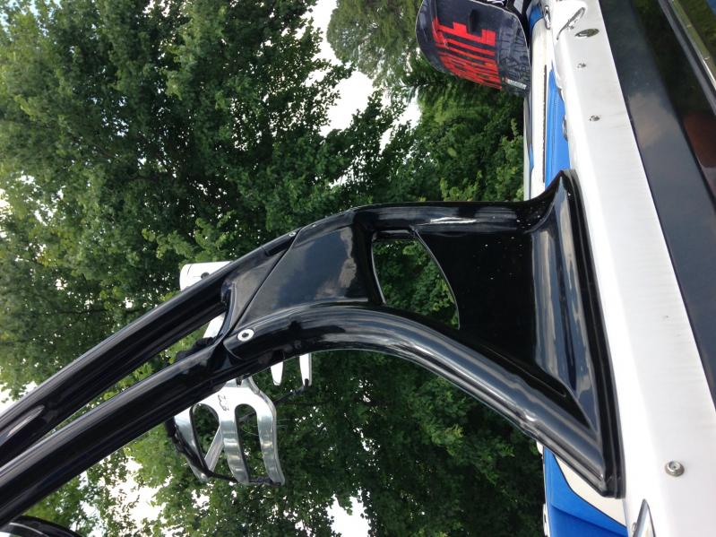

    So the FCT3 tower on my 2010 SAN 210 cracked on the port side over the winter. As soon as I noticed it, I called my local dealer and the service tech said he would check with Correct Craft, saying he had heard of the problem before. I spoke with Roswell and they said they are no longer covering replacement of this, despite it being a design flaw, because they have been sending out notices to every dealer since 2010 for them to check/modify every FCT3 to prevent it from cracking. Of course, the tech at my dealer says he never heard about the service bulletin.
    Correct Craft responded that they will not cover the repair either, so I'm basically out of luck and will have to pay for the repairs out of pocket. Extremely frustrated that the original dealer did not fix this during the 2.5 yrs they serviced the boat prior to my purchase of it. Of course, my local dealer also says they are not responsible either since they didn't sell me the boat. Still waiting for a repair quote.
    I've always wanted a Nautique and heard how great their quality and service was, but I'm starting to doubt that...
    Any thoughts/ideas/other avenues to try?

                    I have the same year boat & tower, bought it new. Not long after I bought it I received the bulletin in the mail alerting me to have it looked at.
                    My tower already was in compliance with the bulletin. I'm guessing you bought this boat used from an owner who did not have the bulletin done for whatever reason.
                    It looks repairable, a good welder should be able to restore the seam with a slightly larger than normal weld. Then get the part repainted, black is easy to match of course.
                    The fix for the water freezing in there is either: install a revised rubber gasket on the base of the tower with a drain slot (what mine has); or drill a drain hole in a specific location per the bulletin.
                    Sorry about your troubles but you can work it out. Personally I would not fight CC or Roswell on it, easier to fix it myself.
