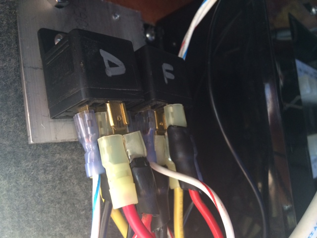

    Wiring was the most fiddly and time consuming. I first assembled a panel with the two relays to be mounted under the helm, then located the wires from the belly fill and drain switches and hooked them to the appropriate terminals. The locker is fairly tight for space, so I ended up mounting the Johnson pump horizontally between the fuel tank and the floor of the boat, then ran the wires up to the relay panel and finally +12v power with a 25a fuse from my auxiliary battery. Nothing was particularly hard, just a lot of planning, clipping, crimping, heat shrinking, zip tying, tucking and tidying.

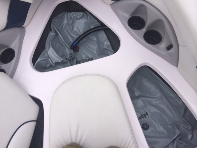

    The plumbing was actually the easiest part! I had however, forgotten that the 1" hose requires a heat gun to get over the 1 1/8" fittings. After 20 min of cursing it occurred to me that I'd needed a heat gun last time, and things went smoothly from then on. Water flows from the intake, to the pump, then T's to a fill/drain for the belly and bow bags. I didn't T the line again to access both sides of the bow bag; Wakemakers didn't think it was necessary and now that I've tested it I agree. Both bags vent to a T, followed by a check valve then out through the factory drain on the side of the boat.

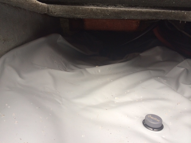

        Where are other people mounting impeller pumps for the belly tank? Space is pretty tight in there because you need clearance in two planes for the pump motor and the hoses exiting each side.
        You can see there's lots of room in the belly bilge for a nice big sac to fill.
