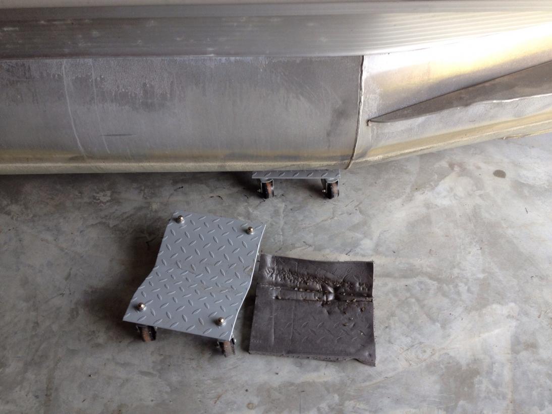

                I basically had the same problem when limited by the township ordnance that I could not build a detached building larger than 900 square feet. In order to stuff everything in I use wheel dollies under both pontoon boats. I picked these up from Harbor freight pretty cheap. As long as the floor is smooth, one person can push these around the garage. I put foam pads between the pontoons and the dollies to protect the pontoons. These work out quite well.
