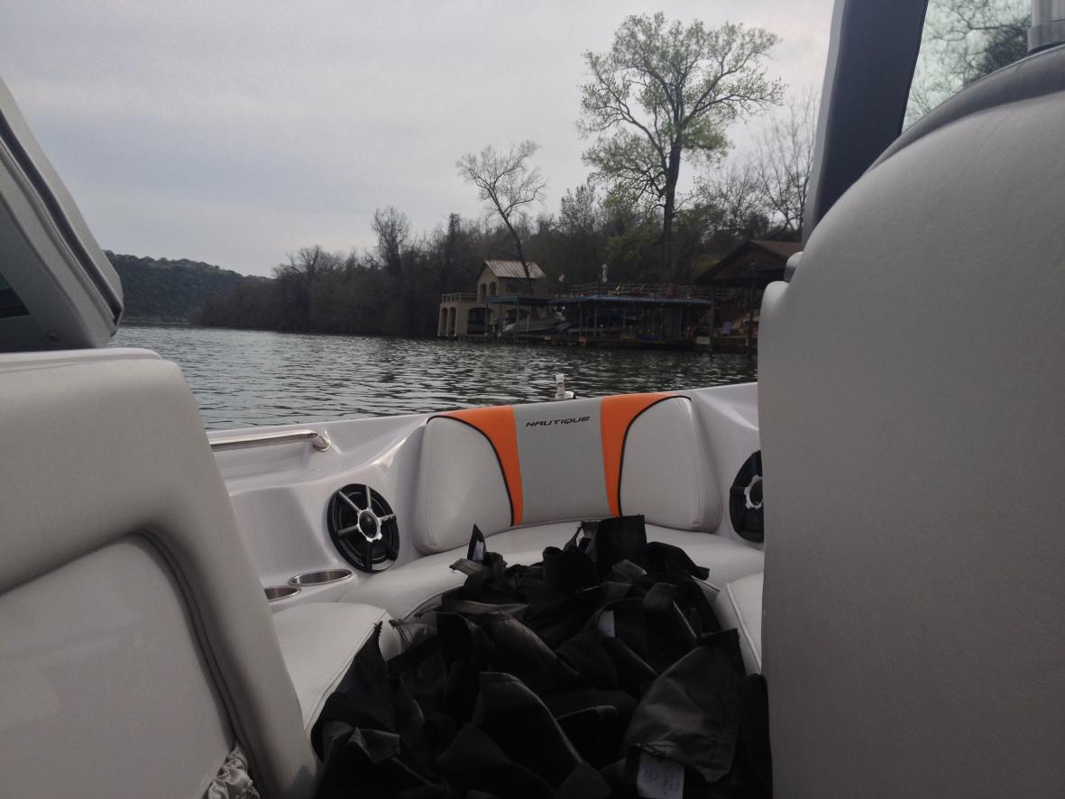

    Boat is a '09 210 with 750lbs piggy in the rear and bow filler sac piggy'd up front. going to have to add ski locker sack to get porpoising to stop. Already upgraded prop btw to a 16xx acme I believe.

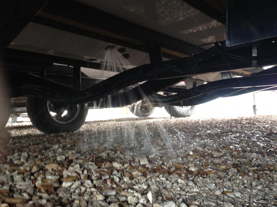

              I might be wrong, but I thought on my '03, they used a bigger mushroom style intake. The tiny a$$ holed discs they are using now seem like a step in the wrong direction. I attached a pic showing the spray when it is emptying. I know those pumps will blow 10x that amount of water. the stock old rule empty pumps would shoot a solid stream 4-5' out the side of the boat.
