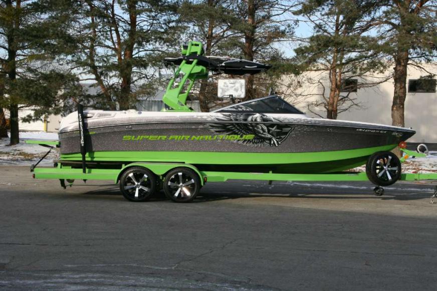

    I've seen N3 do color matched chromax letters on the side of the 210s and 230s several times. Anyone know how they're doing this? Zach? I'd love to do that to mine to match the redflake.

    That would be sick!! It's reallllllyyyyyy hard. You spray it on the paper let it dry then stick duct tape or something of the sort back on it. After you stick the letters to the boat you have to go around the edges with a razor blade to remove it all and make the edges smooth. There is a reason there are only a few boats like that ha. You have to make sure it goes properly too because that frost stuff on the G series boat is well, um, not cheap. What boat is it on? If you really want to I can give you as much insight as possible.
