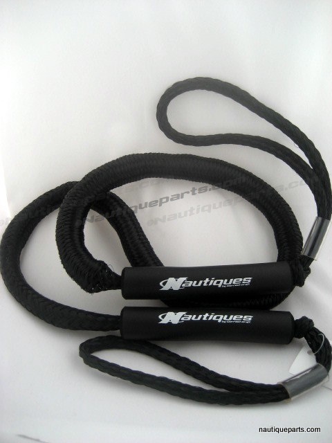

                  I have these and love them.
                  http://www.nautiqueparts.com/docklinenautiquelogo.aspx
