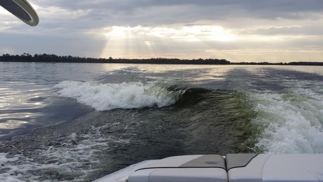

    Thought I would post a picture for all of you thinking of getting NSS on your 2012 210.
    NSS is set at Level 3 (Goes to 5 for the most vert), Stock Ballast with about 400lbs of piggy back on each side, 9.5mph, 2 Adults, 2 small children up front.
    AWESOME!! pulled a 360 the first time on it.

    NSS works awesome on the 210's! Try bumping your speed up to 10.4 or 10.5. Put around 750 in each rear compartment and piggyback a sac in the bow. Your wave will be way bigger and longer than this!!

      Yeah, I need to add a sac upfront, when I had full 700 piggyback tanks full, it was pretty washed out at 10-10.5. I am thinking that we had the boat plowing pretty good.

        Definitely. Adding the piggy back to the front was the first thing we did, then removed the rear tanks and put in 1100 lb sac in the port locker and a 750 in the starboard locker.
        NSS around 3 or 4 for the port wave, 1 or 2 for the starboard wave.
        Have fun experimenting!

          On the picture taken was the boat evenly weighted? We have the nss installed on our 2012 210 and we need to put weight, about 60-40 towards the surf side, every time we surf. Im trying to find a configuration where we can evenly weight the boat.

            As far as I can remember, the boat was weighted evenly at the time.

              While I have an 08. It’s essentially the same boat. I also have NSS. I run 1100’s in the rear. Piggy back center sac and 360lbs of pop bags in the nose at 10.5 . To get the best surf wave possible I’ve found a slight list ( more weight on surf side ) is greatly beneficial . It’s not a straight up list but there is an ever so slight lean. My surf side is filled completely and non surf side is about 2/3 full.
