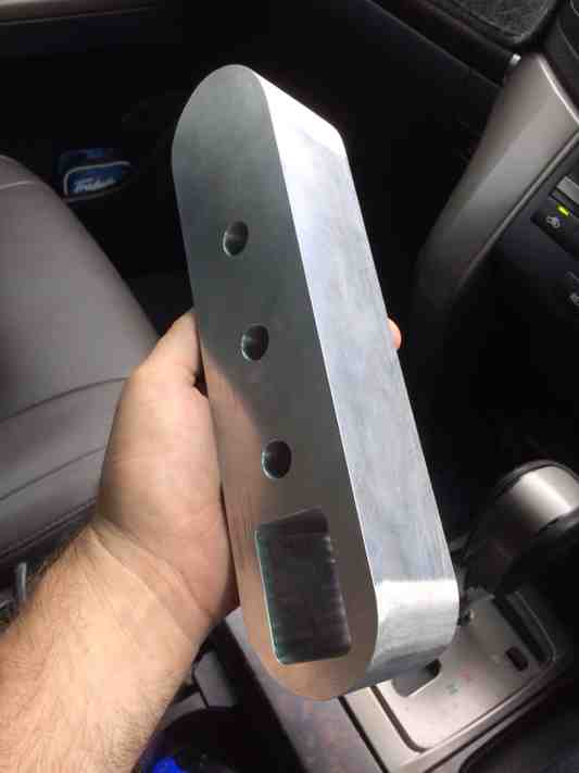

    The tower was 100mm too narrow for the boat, so I had some billet spaced made and put longer bolts into the top either side if the centre section

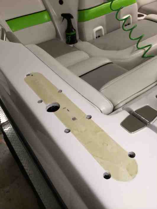

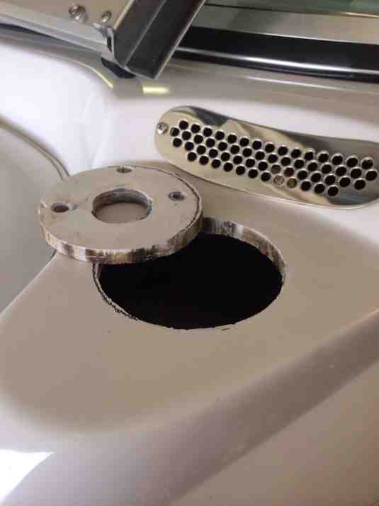

    We then removed the stainless steel step plates and glasses up the old insert as that's where the tower sits and I wanted a good solid base. I then drilled all the mounting holes

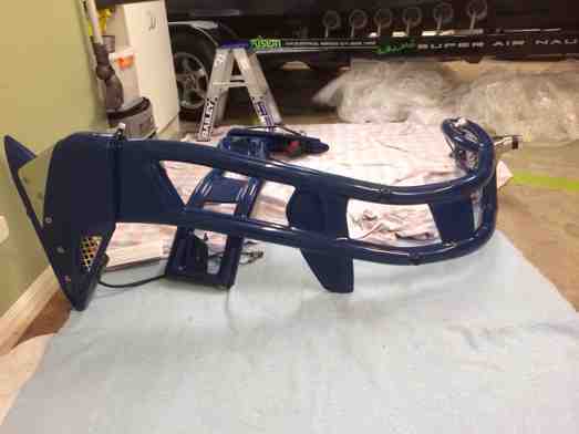

    With everything fitting well, it was time to break it all down and send to paint. Colours came back amazing!

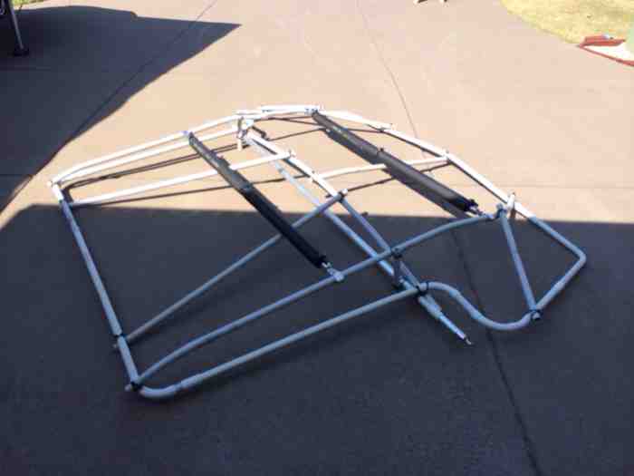

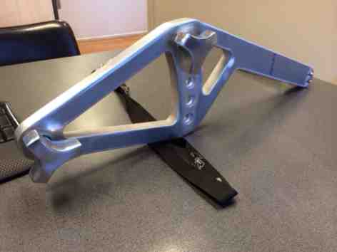

    Not time for the bimini. A designed and had water cut some 20mm thick, height adjustable side arm to mount a Z5 style rack onto. The arms are held in place by the same knobs that are in the tower so no tools are required.
    After this I fabricated a mock up rack using PVC conduit and zip ties. We will finish fabrication on the alloy frame tomorrow which we will the get powdercoated black along with the side arms
    All the fitting used on the bimini are the same quick release ones that the factory uses. The main support arms are also telscopic slip yokes to allow for the arms on the side of the tower getting wiser as they get lower.
    Quick release clamps for this will arrive next week when the boat is off getting canvas done.

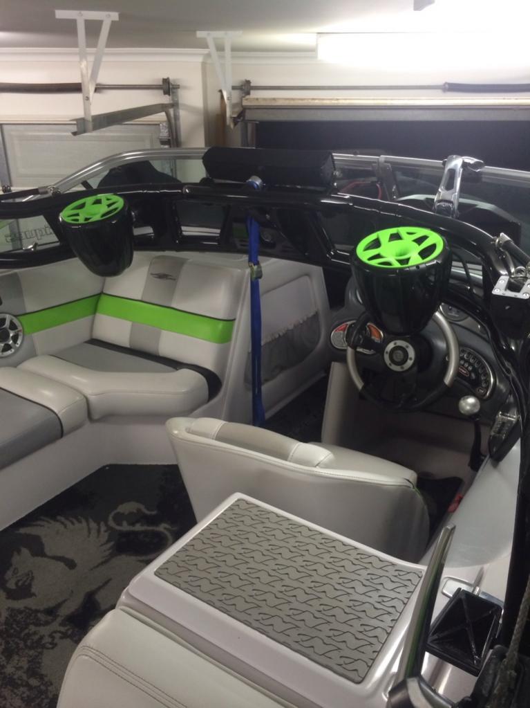

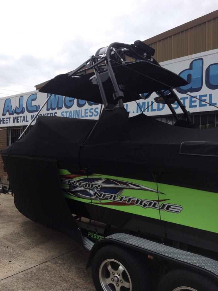

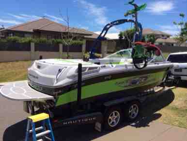

                    Canvas work is done on bimini and boat cover and exile speakers mounted
                    Front silver bars are only for transport and remove in two seconds each. I prefer bars rather then straps as straps don't stop the wind pushing down from the top .

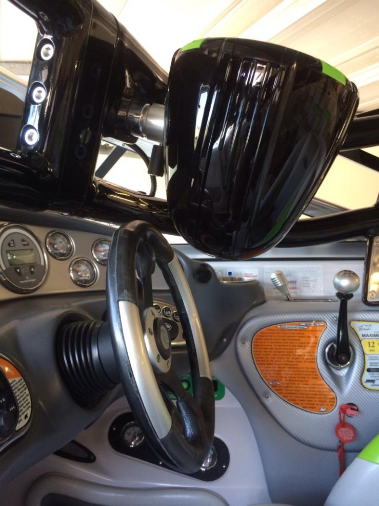

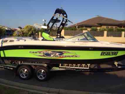

                    Forgot to get some final photos on the weekend, but did get one of the speakers greened up. Looks different but I think I like it.

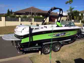

                    Thought I would have to remove the drivers side speaker to fold the tower but turns out everything clears and this is not required, bonus!
