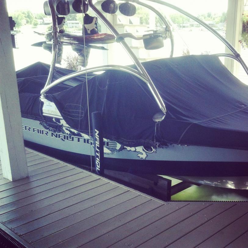

I can't tell you what distance mine are set apart but I can tell you that I measured the bunks on my trailer and set the lift bunks up to those approximate locations. Seemed to work well. I made my own side guides and wrapped them in carpet. I set the height of those below the "nautique" lettering and about 3" away from each side of the boat.

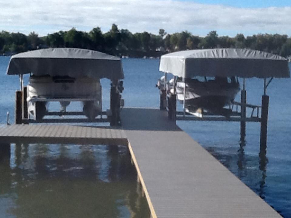

Sorry no measurements. But my 2008 210 sits on a 5000lb capacity shoremaster 50120 cantilever lift. I have full length carpeted guide ons and i simply have 2 set's of the pictured cradles (front and back). In front they sit far enough apart that boat is about inch or two from rail. And in back high enough that the center tracking fins go over. But really not an issue as boat is way higher when lift is down and boat is going in and out. When boat is raised I think the propeller shaft is 2 or 3 inches from the rail.Last edited by scottb7; 01-13-2014, 12:52 PM.
Thanks! Would you please also tell me the height of the wood and the brackets that set on the beam?

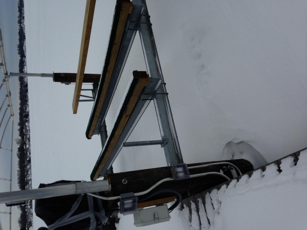

My 2008 210 sits on two pair of 2x12x12" bunks. They are 26" apart. I would like to have them a little further apart, but the brackets are welded. It sits solid as a rock!!2008 Super Air 210 Team

I was there today but it was snowing hard, I'll do it on Sunday. My biggest fear is that huge water intake! I'd hate to let that bunk get under it when lifting2013 SANTE 210
