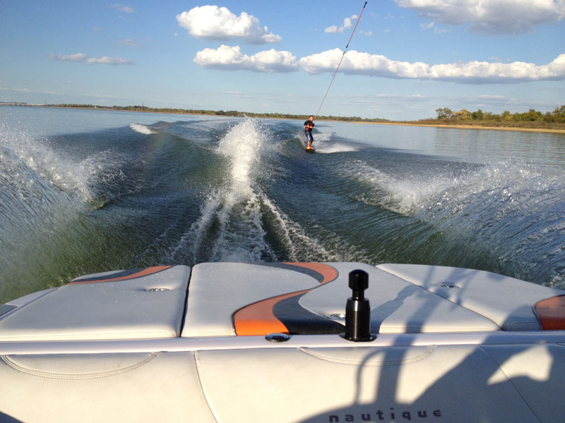

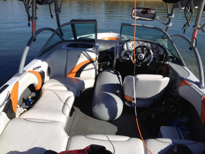

                    Something is certainly wrong. I ride the same boat with a friend all the time and the wake is money. I am nearly certain he is not even running the 750's but 500's in the rear. Those are 2 400's one in the bow and one in the walkway. There is some lead around the rest of the boat. The extra 400 in the walkway is what gives this boat the extra ramp compared to the more steep wakes this boat normally has. Picture riding is at 23.6 at 75ft.

                      Correct setup for above.
                      150 lbs lead under rear 750's "I am not sure these are 750's but Brent swears they are"
                      300 center ski locker
                      300 in the walk through
                      400 in the bow
                      250 lead under bow seats.
                      If you remove the 300 in the walkway the boat cleans up at the same speed but has a much more vertical face to the wake.
                      If I had my guess your running to much weight in the nose of that boat or your speed is off a good deal.
