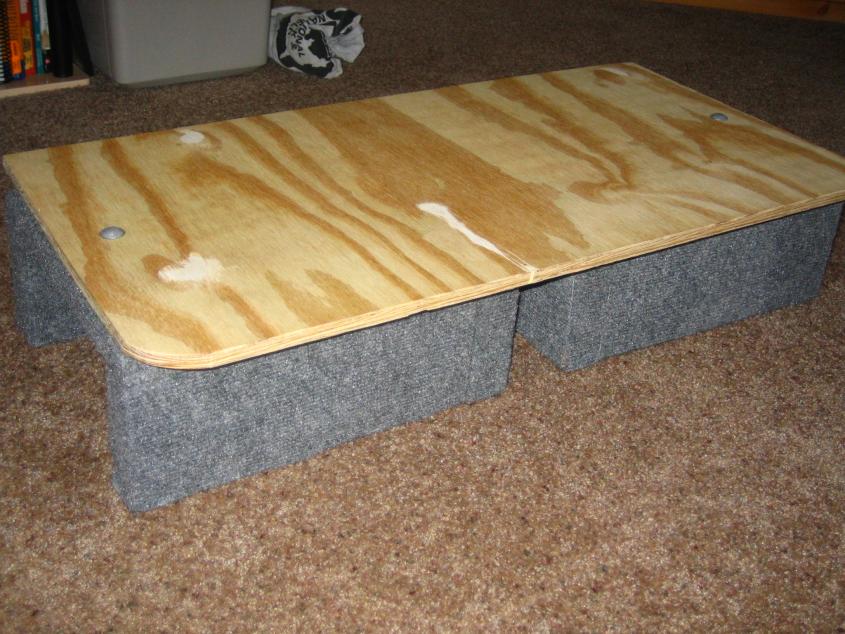

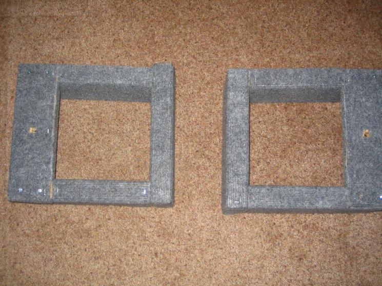

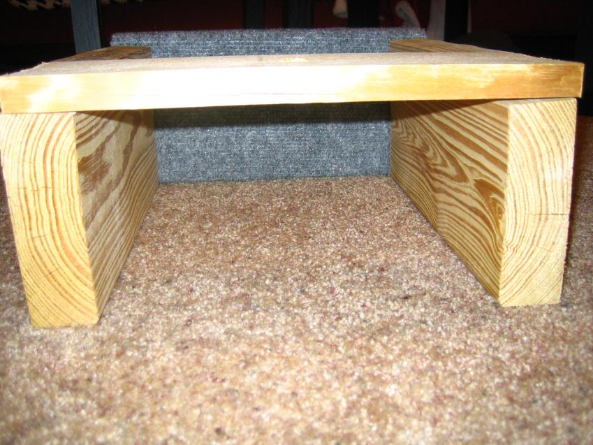

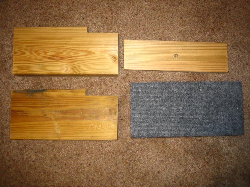

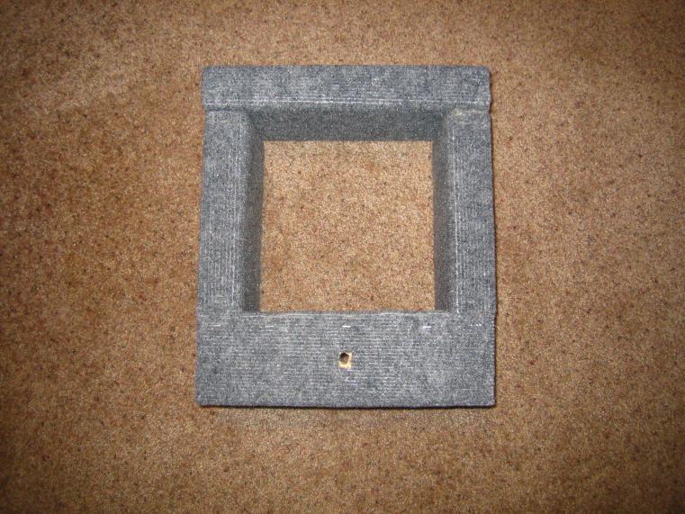

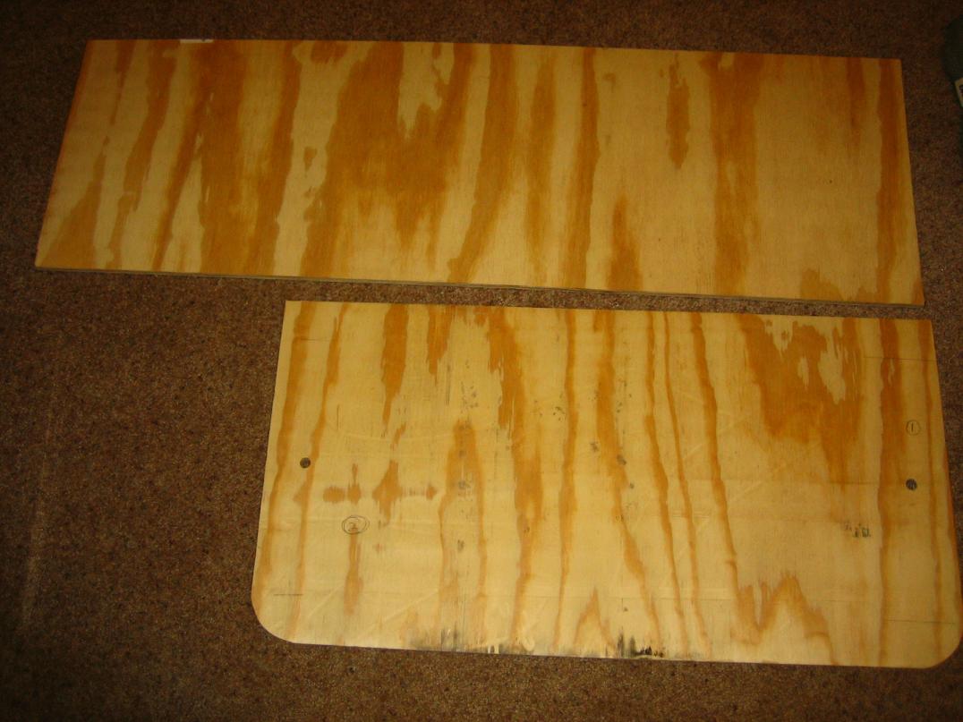

                          I started on the seat when I was home for Christmas. I drew up the plans, and my father in law and uncle helped me cut all the wood. I am going to make two 12W x 12L x 6H boxes as bases for the seat. I used a 2x6 for 3 sides and I a 1x4 on the fourth side. I drilled a hole through the 1x4 and the seat base. Each hole will be approximately where the holes are on the 230 for the removable middle seat.
                          The goal is to have a removable seat that meshes well with the current seating. The base for the seat is 1/2 inch plywood. It is going to be 16x32. I think it will be more than enough room for one person and should fit two smaller individuals. I made the backrest of the seat longer as it will continue over the bench seat on the drivers side and lean up against the back of the drivers seat. I am going to attempt to make it a folding seat.
                          I still need to order hinges, foam, and vinyl. This is my first project of type. I haven't used many power tools since woodshop about 10 years ago in high school. I want it to be up to nautique standards, but my main goal is to complete the seat and have it work and be functional.
                          I have attached a few photos. I carpeted one of the bases tonight. I still need to put the screws in it. I am getting excited that my ideas are starting to come together and I think it should work well.

                            I have the bases put together. I also have the foam cut and the vinyl. I am just trying to decide whether I will sew the vinyl myself or have a shop assist me with it. Here is a pic of the seat on the bases, and a picture of the screws I put through the seat base that hold the seat to the bottom bases. The goal was for this seat to be easily removable. So far with the cost of wood, screws, foam and vinyl I am right around 100 dollars total.

                              Here is the other photo.
