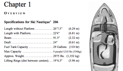

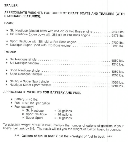

    There was no 206 in 1996. The 206 came out in 2003.
    If you have a 1996, you likely have a Sport Nautique.
    Here's the weight info for 1996 boats.
    Just in case, here's the weight of the 206. You'll have to add in the trailer weight.
