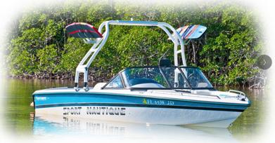

    I have a ND tower on my 94 sport and it was worth the money. I waited untill they have there sale at the end of the year. My boat is the one they used for the pic of the 93-97 sport on there website.

      You might also consider the Roswell Aviator tower. They look great on the Sport Nautique.
      http://www.roswellwakeair.com/series...tower-aviator/

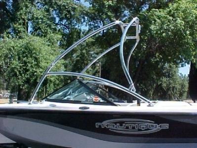

            Oops, I meant to attach this pic I found on google showing what it looks like on a Nautique:
Name:	diywake tower.jpg
            As I mentioned in my last post it will not follow the lines of the windshield but it is a solid tower at a great price.

                  Thats a diywake tower on a newer sport

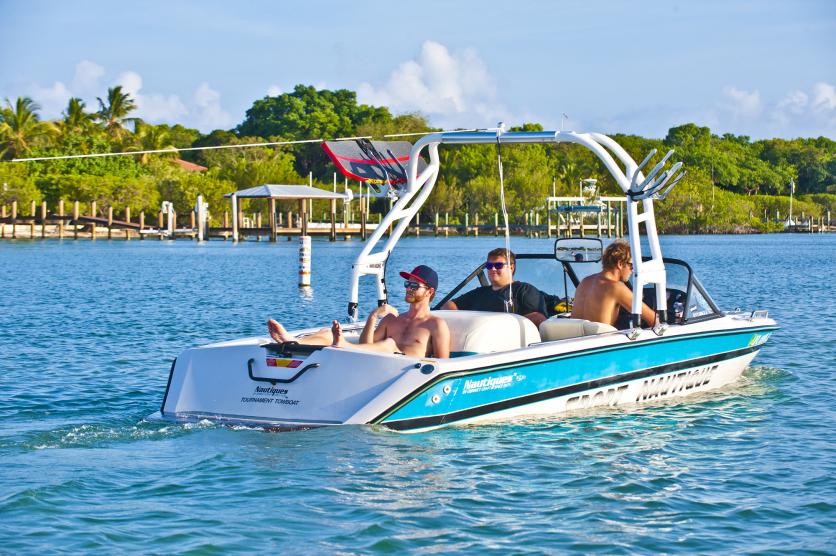

                    I'm with Jeff. The Aviator is awesome and it would look killer on that boat (pictures case in point). The white tower is the mac daddy with assisted fold down and spinner racks where the black one saves you some money. We just got 2 white ones and 1 black tower at the shop. We were slated to install the white one on a 95 Super Sport but plans changed and the boat was sold to an owner sans tower.

                      Great question!
                      I feel I may be qualified to help you out. Two months ago I installed the Big Air Vapor tower on my 1997 Sport Nautique.
                      I drove from Canada to Austin, TX for the Sport Nautique after finding it on the planetnautique classifieds. From there I turned around and drove straight to the headquarters of Big Air Wake towers in Duncan, OK where they measured the boat and CONFIRMED the tower would fit. Loaded up a tower and some racks and continued on my journey. Apparently they very rarely get anyone show up at their headquarters as 99% of the business is done online.
                      Here are some things you need to know.
                      1. It fits.
                      2. I found a spot that was optimal for the front legs of the tower. It turned out that directly underneath there is a fiberglass piece that gets in the way of the reinforcement on the underside. This fiberglass piece is what the blower tubes attach to. The blower vents are right in front of the windshield. We couldn't use the exact hardware because of this and ended up using very large washers on two of the bolts on each side for the front legs.
                      3. We wanted the arms on each side that attach to the boat (run N/S on the top deck) to be near vertical. This took some adjusting but we were able to get the job done.
                      4. The front tower arms that swoop upward ended up having some tension to them. You have to physically pull them inwards before bolting them in. This is only an inconvenience IF you have to drop the tower and bolt it back up. I was in a position where I never had to fold the tower. Because the tower fits "tight" on the boat, the extra tension makes it more difficult (not impossible) to fold and then put up again.
                      5. On the plus side... because of the tension ours DOES NOT RATTLE. It is solid. One of the things I hate about budget wake towers is the rattles and shaking they do when going over chop. I just ensure that the bolts are all snug after long tows and every so often after using it.
                      6. I am overall VERY pleased with the tower for our purposes. I would highly recommend it unless ease of folding is of priority to you. But like I say... it's not impossible.
                      But.... what kind of post is this without pics! We went with the black tower and black racks and absolutely love it! The racks didn't make the pictures until the last one.

                            I do like the swoop on that tower though.

                              Ya that does seem to follow the lines of the boat pretty well for a universal tower. Looks great!
