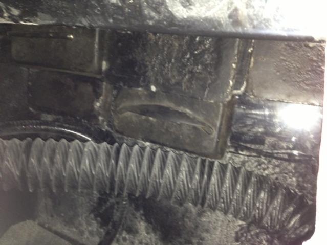

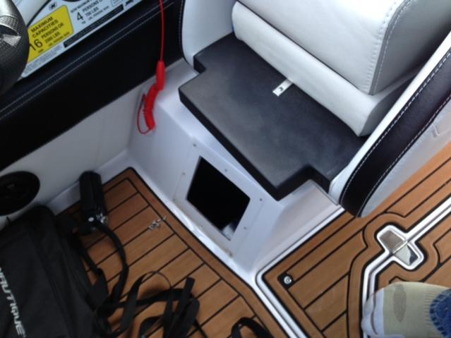

      There is a little silver panel by the drivers heels. Just big enough to get my home made bread pan bricks through with my hand on them.
      • kopp210
        • Jun 2006
        • 129
        • IN
        • 2013 G23 550 2007 236 6.0 (All White Ghost Ship) 2003 210 PYTHON (RRRRhhhaaa!!!!)
        #78
        There is a lot of space down there. Could be a possible custom bag location, prollay 400-500 lbs. Would be all under the floor and not use existing storage space. Especially good if you were going to plumb it in.
        Could match it up on the passenger side with a tube sack or something that just fills the deep well portion of the underseat storage compartment. Wouldn't lose no space on the driver side and only a little on the passenger side, and add 800 lbs or so.
        **This is all from memory, may be much smaller, I haven't been in the boat for a couple months, but I remember the space being large enough Nautique should have used it for something.

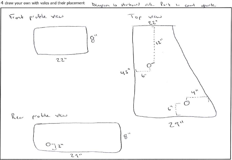

          Originally posted by ironj32 View Post
          If I get custom bow sacs made, they will be one of these two. They are longer and wider than one would suspect could fit, but there is a lot of extra room way up front and up the side walls.
          ironj32, given your experience im trusting what you say. I can def see how there is a lot of room in the front and up the walls.
          My only comment is the space I measured is 8" tall and you have them shown as 12" tall. I dont see how there is extra room beyond the 8" height to justify a taller bag.

            also I think if plumbing them in the top vents at the fatter end of the triangle need to be on the angled side, not the flat side. That way they are closer to the side of the boat to use for an overflow. The other vent seems properly placed to access when the seat is open.

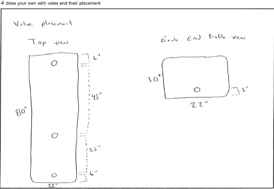

              This is what Im thinking. Excuse the crappy pic and handwriting as I dont have the time to make it quite as fancy as the other one. This seems a decent compromise for how I am guessing the space will accommodate the bow bags and accounting for overflow vents.
              The mid/rears I am going with a single configuration but if double the previously mentioned one seems great. Always easy to switch to the double.
Name:	G23 bow sacs custom order form.jpg
              The odd top vent placed 31 inches from the end puts it roughly at the front of the rear gunnel and is best place for out of way overflow vent.
Name:	G23 mid-rear sacs custom order form.jpg
              Also in my part list forgot the shutoff valves for the thru hull and the clamps for that. Also 4 backflow preventers (for overflows) and clamps for those.
                  I made mine taller than the space allows because I prefer to not have the bags bulging and busting at the seams. When those bags get completely full there begins to get a lot of pressure in there and they pressing up on the bottom of the seats, frames, hinges. If you do them a bit taller, it releaves the force that's exerted. it will also allow for the bags to fill up the side walls more. If you get down and reach around and measure along the outsides, you'll see that there is a lot of room.
                    The reason I have both vents on the inside edge is because I do more of my filling manually. I put the hose on the rear one, and then just crack the forward one a bit to let the air out. I could see how placing it on the wide side would be beneficial if you were doing an auto ballast, and didn't need to do any manual filling.
