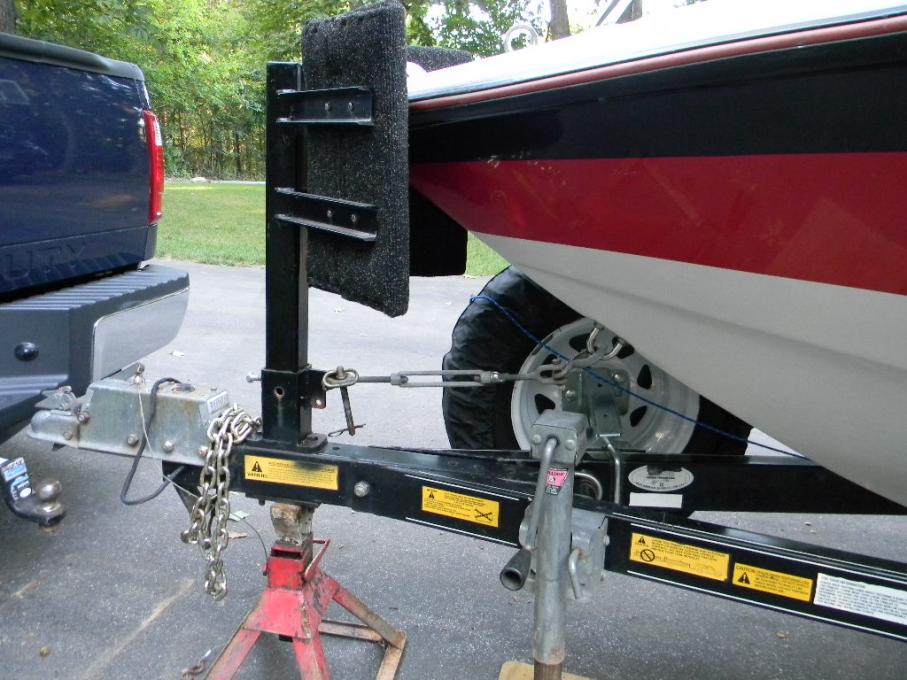

                      I wish I had an option other than powerloading but my Ramlin trailer does not have a winch and is meant to be a drive-on trailer. Someday I will probably modify it so I can add a winch but at my regular ramp I can idle most of the way up and only need to give it a little bump to get into the V pads and hooked up.

                        S Kelley, I would think that you could still deep load your boat by pulling into bow stops and attach the turn buckle or safety cable, then pull up and let trailer come up and boat settle on the bunks. I essentially (even with winch) pull right up to the bow roller/ stop attach winch hook and safety cable and then pull up slowly. The trailer comes up from deep and boat settles directly down on to bunks without having to power load at all. Without seeing you trailer of course my input is just that.....

                            Unfortunately there isn't really enough "slack" in the turn buckle to do that. With the trailer deep enough for the boat to travel all the way up to V-pads without powering on, the boat is floating too high relative to the trailer for the turnbuckle to hook onto the bow eye. If I pull the trailer up slowly once the boat is in position the boat ends up sliding back a little and is now too far back for the turn buckle to reach. I have tried a few times and with my usual ramp I can't find that sweet spot where I can float it on and have the turnbuckle reach. But I have found a good spot that requires minimal power to load. Here is a pic of a trailer that is set up like mine:
