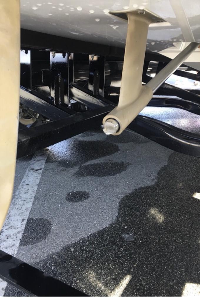

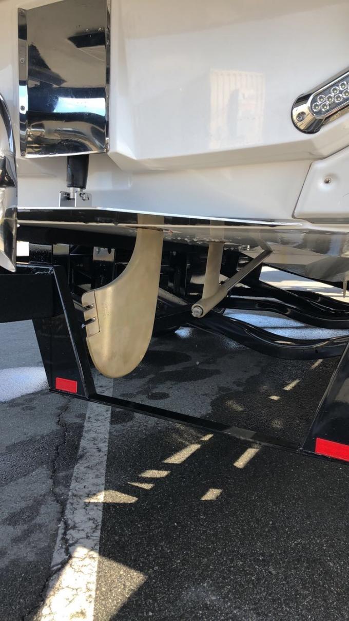

        Yep. Total bummer today same happened to me at the beginning of the weekend
        2018 G23 at about 80 hours
            Sorry to hear that you have joined this club. Make sure your prop didn’t put a hole in the hull.
