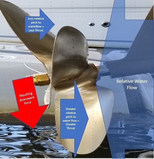

                    I think there is a misunderstanding. There is NO left and right force that can fatigue the shaft. Both the left and right blades experience the same relative waterflow and therefore generate the identical thrust. It is the top and bottom blades that cause the resulting downward force that causes the shaft to fatigue and fail. I have discussed this with several engineers very experienced in propulsion design. Perhaps you are thinking about prop torque. But prop torque causes the boat to roll to the opposite side of the prop rotation. This force is directly longitudinal to the shaft. It does not cause ANY asymmetric force that would fatigue the shaft.
                    Here is a picture to help one understand the issue. Both boat pitch and shaft angle combine to cause the top blades to become more PARALLEL to the water flow, reducing the relative pitch and thrust of the top blades. While the bottom blades become more perpendicular to the waterflow enabling them to generate much greater thrust than the top blades.
                    Click image for larger version  Name:	Relative Pitch.JPG Views:	1 Size:	64.3 KB ID:	560219
