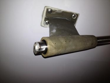

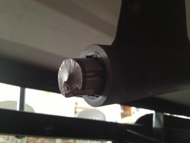

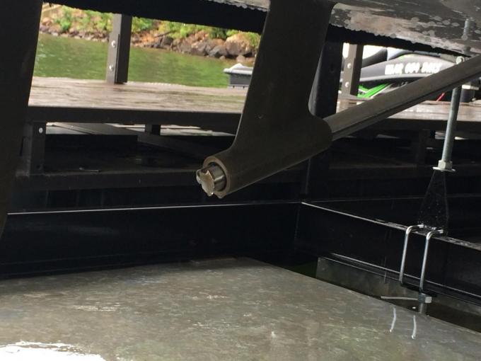

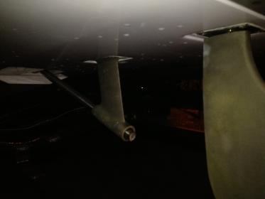

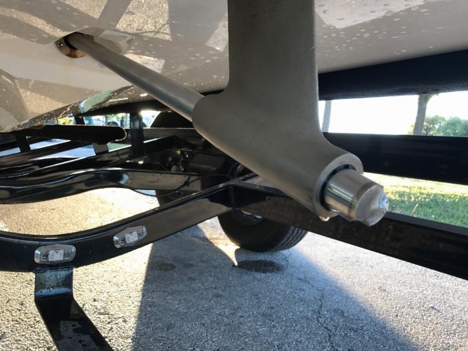

              #216
              Jeff is wrong--- that is NOT where all the others have been previously breaking...
              Interesting. Here are some pictures of others that have broken. Sure looks like a similar spot to me. Longhorn's might be just a tiny bit further down than some, but the general location is certainly similar.
              Here's Longhorn's prop shaft:
              Click image for larger version  Name:	longhornshaft.jpeg Views:	1 Size:	169.2 KB ID:	515724
              Here are six others I found with a quick Google search:
              Shaft 1:
              Click image for larger version  Name:	shaft1.jpeg Views:	1 Size:	40.4 KB ID:	515730
              Shaft 2:
              Click image for larger version  Name:	shaft2.jpeg Views:	1 Size:	28.6 KB ID:	515729
              Shaft 3:
              Click image for larger version  Name:	shaft3.jpeg Views:	1 Size:	34.9 KB ID:	515728
              Shaft 4:
              Click image for larger version  Name:	shaft4.jpeg Views:	1 Size:	21.7 KB ID:	515727
              Shaft 5:
              Click image for larger version  Name:	shaft5.jpeg Views:	1 Size:	13.0 KB ID:	515725
              Shaft 6:
              Click image for larger version  Name:	shaft6.jpeg Views:	1 Size:	26.4 KB ID:	515726

                Most of those seem to have the dark ring as well. As for my prop and boat. Once again, had 30 hours even on it. Was in 80 feet deep water. Smooth water but broke off going over the crest of a small wave from another boat. I check the prop before each outing and it was normal, no wiggle or unusual movement. Original prop on the boat from the day I bought it.
