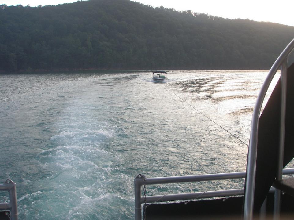

                          We typically ride ahead with the Ski Boat when we leave the marina to scout a spot and in the morning when we are returning to the marina, when it is typically flat calm and everyone is packing an cleaning to return the houseboat, we tow it behind with about 50' of rope. Have never had any problems.
