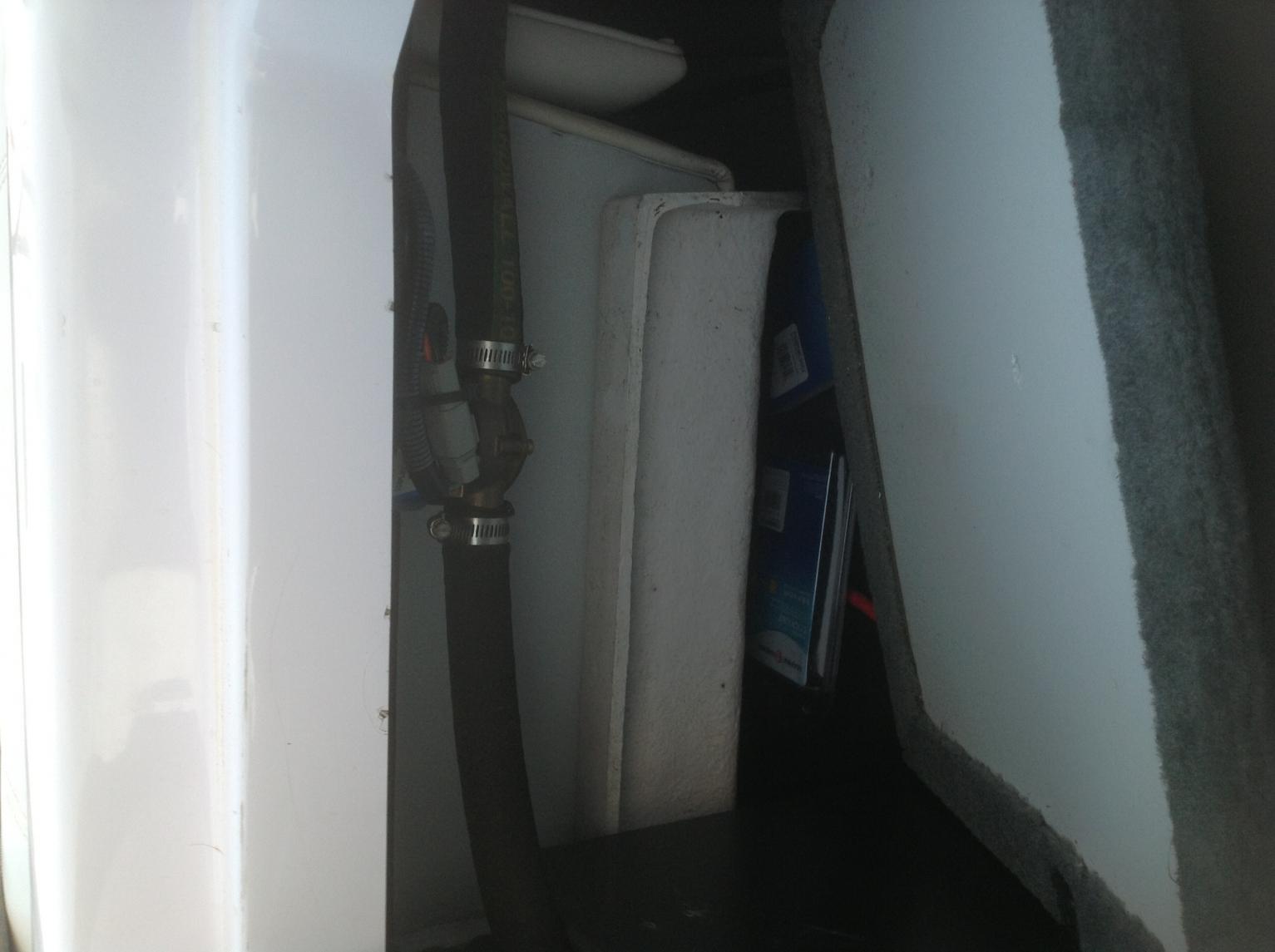

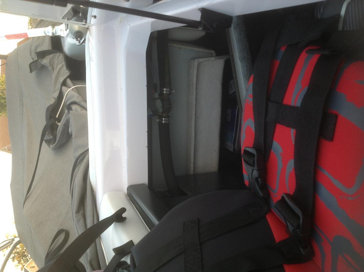

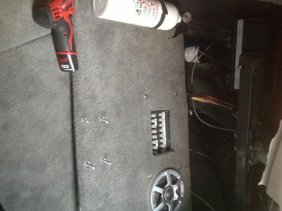

        Your going to have to use your imagination for the port side.Click image for larger version
ID:	366612Click image for larger version
ID:	366613Click image for larger version

          Thanks! That will help. Looks like they used the space the electric actuators for the hatch release only boat so I won't be able to put them there. Thanks again for the pics.
