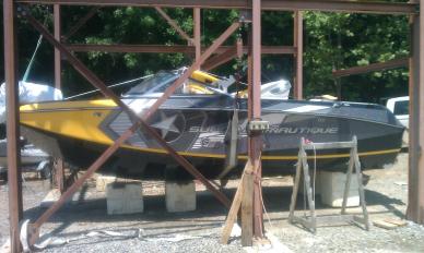

              #21
              Best I can do for a pic until I pick it up tomorrow!
