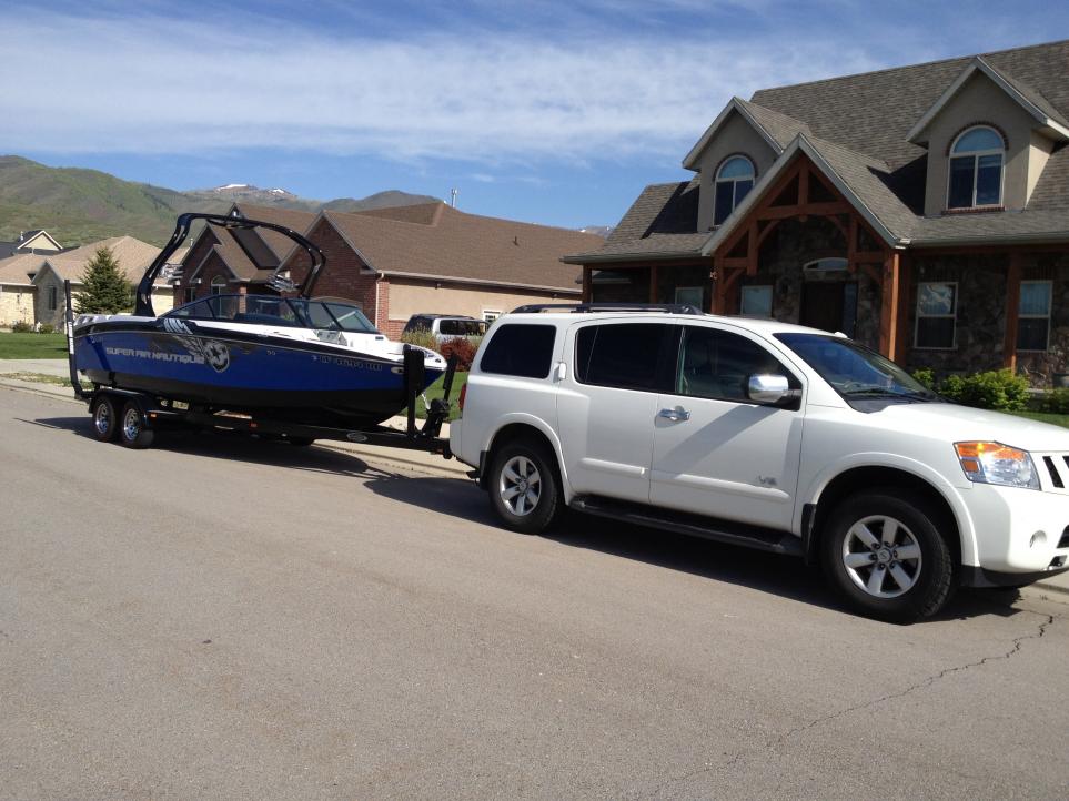

                        I ve had two Nissan armadas. I pull my 210 all day long with it. Can't tell it is back there. Stops excellent also. I have to say to 2012 armada pulls better then my 2005. Due to tire size. I think they are rated at 9100 lbs. also I have pulled a 26' cobalt and San 230 with it. Same as the 210. Not sure i would pull a g23 though to much weight.
                        I too have an Armada.I use it to pull my 2009 230. I believe the weight is 4400 + trailer + everything that is put in it. Pulls great. The only issue I have with it is that the auto leveling system in the rear suspension is piece of crap!!
