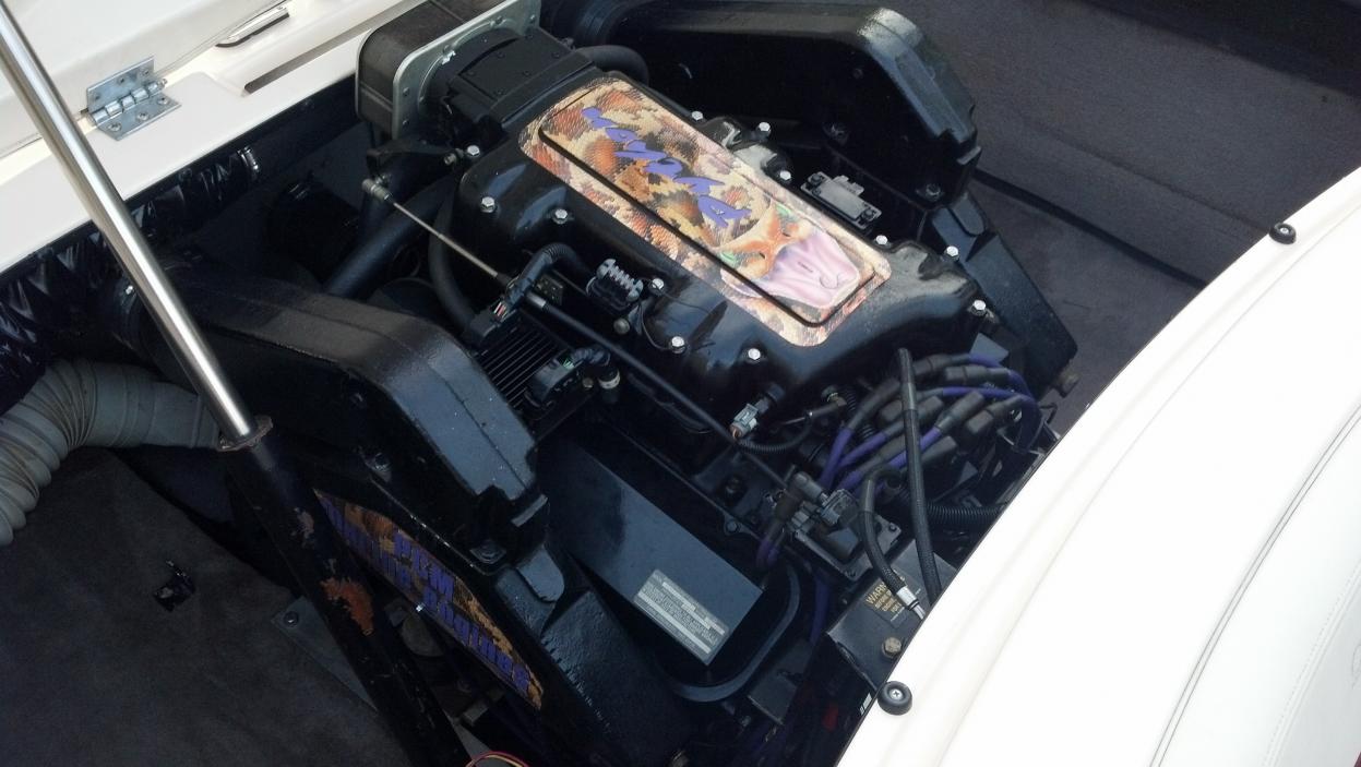

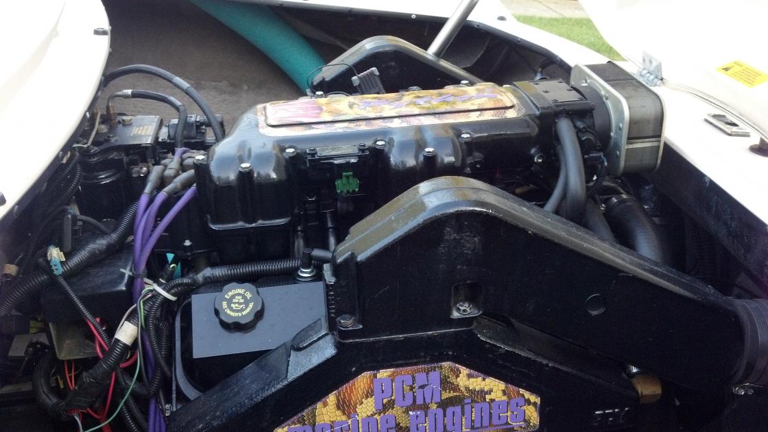

          Here are a few pictures of my 1999 python with the dividers removed.
Name:	2012-07-12 20.29.06.jpg
ID:	366512Click image for larger version
Name:	2012-07-12 20.30.55.jpg
          By the way, I'm glad to see that you also have the "5W-30" oil fill caps. Until I saw your picture... i thought that my oil fill caps were not original.
          http://www.planetnautique.com/vb3/sh...984#post175984
          1999 Super Sport with Python 502
