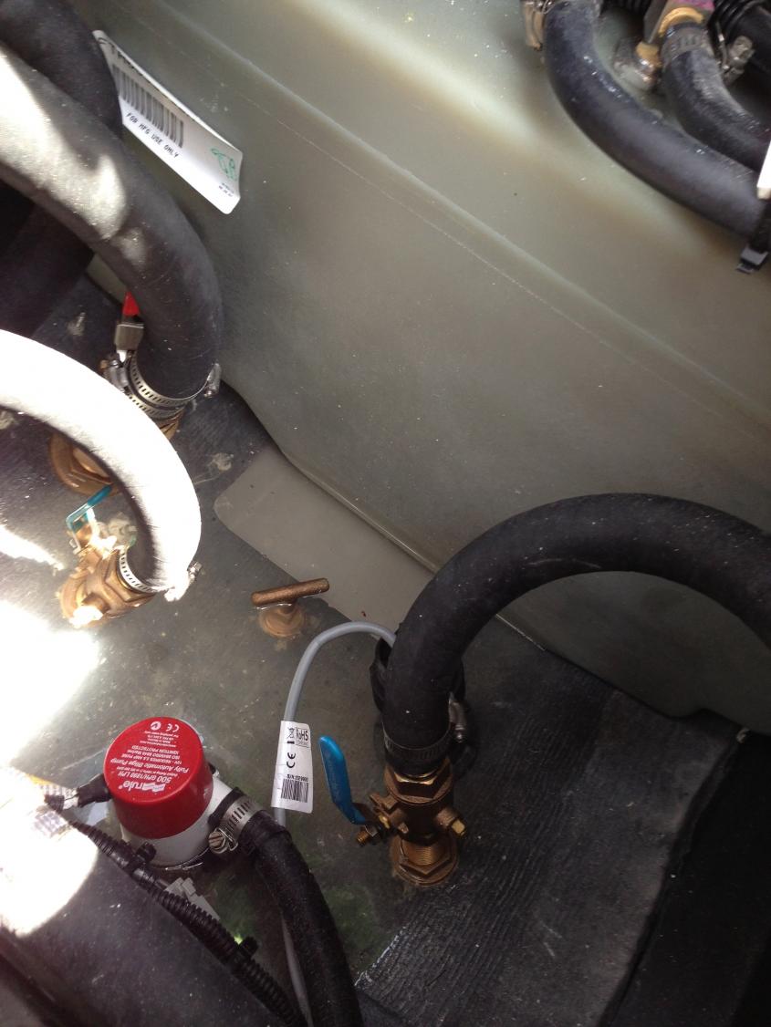

ID:	366108Click image for larger version
                      yes. This is the view of the water almost to the bottom of the t-handle after 3 hours on the water. Some just parked and riding(varying) speeds.

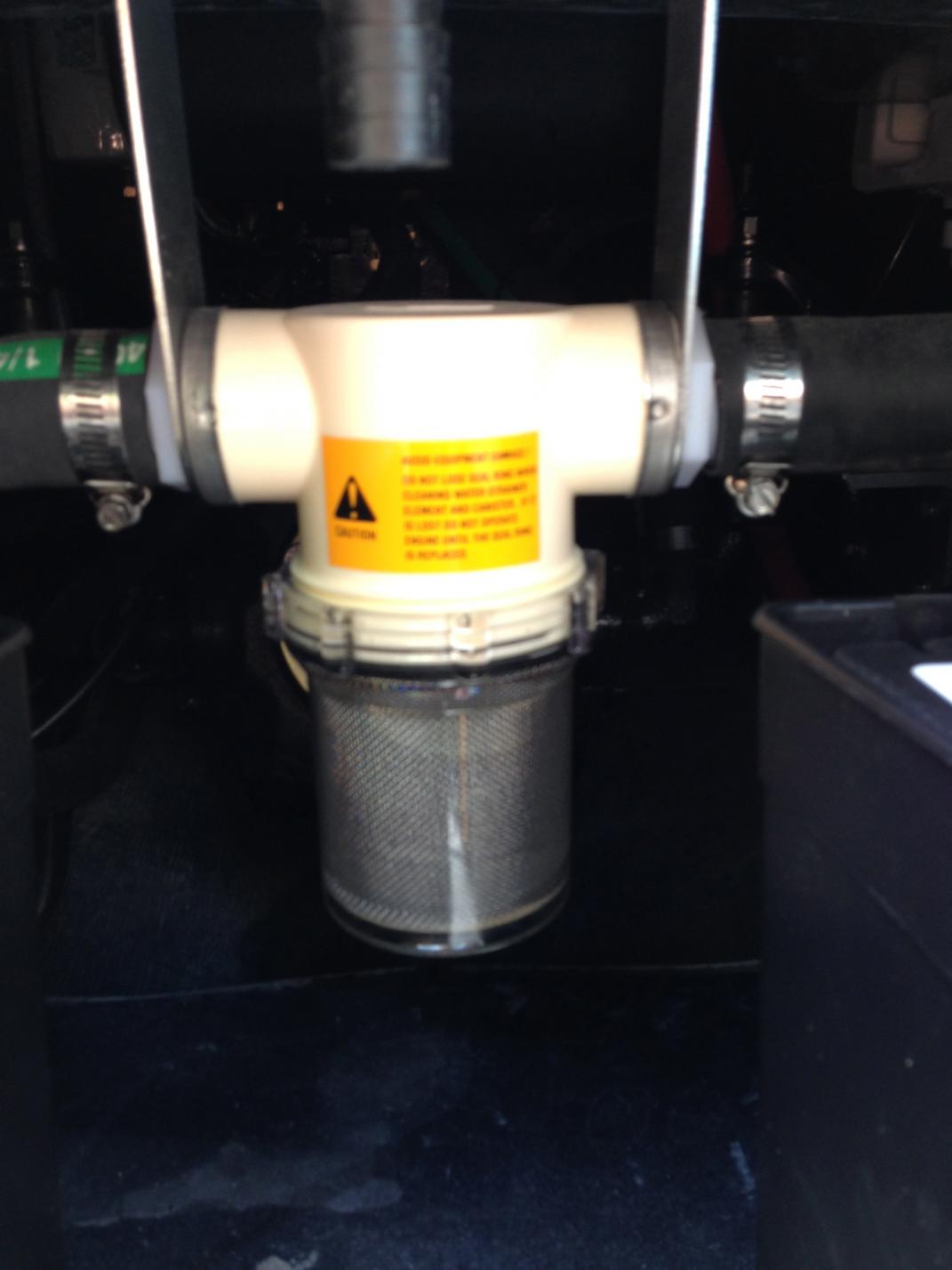

                      ...and the strainer was wet around the top threads and the bottom of the 'cup'. There was some water on the 'hump' under the strainer, but did not see the drive unit while underway.
                      2013 SAN G23 450
                        2013 SAN G23 450
