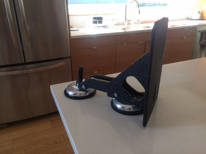

                  you revived quite the old thread. Ideal weight for this Hull how changed somewhat with all the new custom ‘suckgates’.
                  Search for the DIY surf gates, I made one for about 30 bucks (industrial glass suction cups and cutting board, and it has completely changed the game. Full both rear lockers, full belly and full bow sacs. Basically full displacement. It fits perfectly on the back where the hull slants towards the swim grid.
