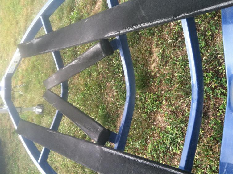

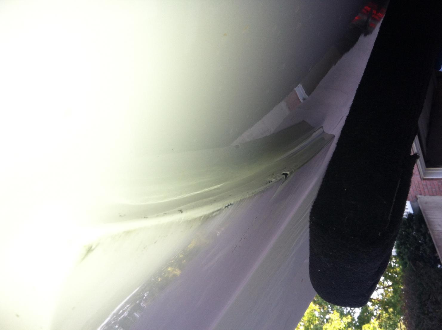

              We had a Boatmate under our 200 last year and after the Boatmate trashed the spray chines (understatement, pics attached) we repaired the boat and replaced the Boatmate with Phoenix after quite a bit of research, which included conversations with Phoenix. The owner of Phoenix Trailers is a skier and has a 200, so with some trial and error refined what is a very solid trailer. So far the Phoenix trailer has done very well. I have been happy with its trailering and there are no signs of damage to the boat with the Phoenix.
              The pics show how the horrible design of the Boatmate eats and chips at the spray chines. We had chunks out of the chines on both sides. Boatmate's response was that the trailer we had was an improvement on the previous design, which did not have the long wide bunks and therefore allowed the chines to get hooked on the trailer when unloading. Beyond that, they were silent. If you have a Boatmate, I recommend very carefully floating the boat on and off of the trailer until you buy a good trailer.

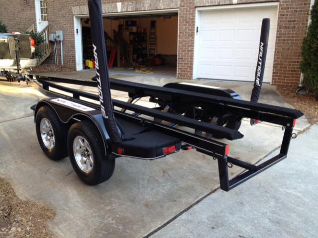

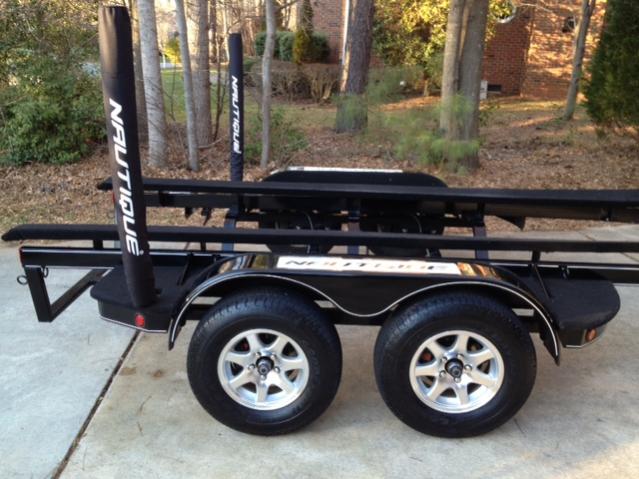

                      Shameless plug - I have a Ram-Lin tandem axle trailer for sale (used only freshwater.....very light use) from my SANTE 210 that might work for your 200V. Trailer is in excellent condition as boat was kept half of its life on a lift and then trailered 100 yards down the street in my neighborhood to our community ramp (stored indoors when not in use). Let me know if you're interested (I also have it up in the "Gear for sale" section. Would be MUCH cheaper than buying a brand new trailer.
