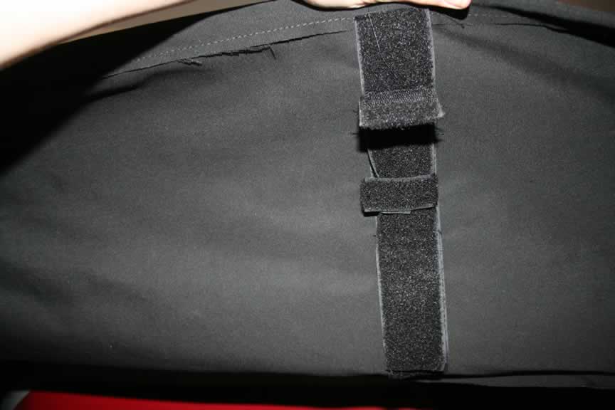

            2. Put all the 'J' hooks on the cover in about the middle of the velcro patch. (I attached a image of my 'J' hooks) Now put all the 'J' hooks over the rub rail all the way around the boat.
            3. Adjust the 'J' hooks by tightening/loosing them by moving them up and down on the velcro patch. Once the 'J' hooks are in the proper location they should almost pop into place and stay hooked. Your cover should look tight all the way around the boat and should be tight from side to side all the way up and down.

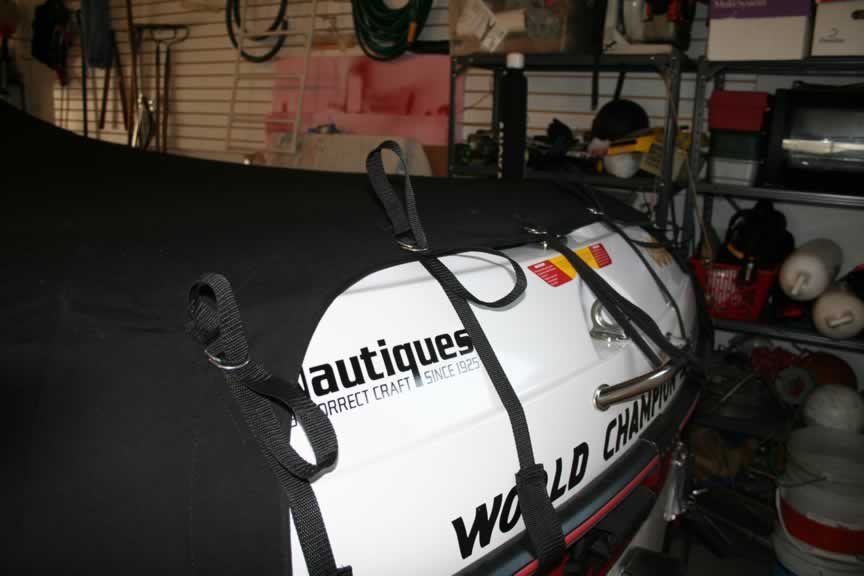

            4. Now that the 'J' hooks are installed and adjusted you can secure the rest of the back of the boat. I always use a loop method for easier removal of tight straps. (Another included image)
