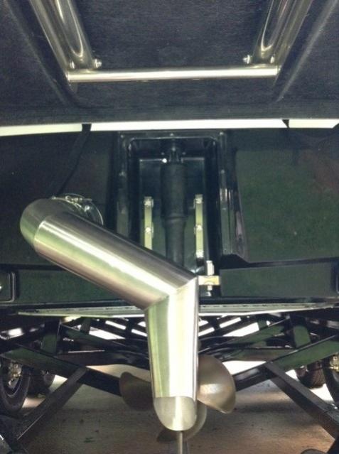

FAE installed today. First test was only surf wake speed with no riders and about 30 minutes of run time. It stayed on with no problems. Install went pretty good but took a while because I measured more than I probably needed to. It helped to have a drill press and chop saw with a metal blade. I put extra reinforcement on the inside of the boat. The only problem that I have is a bolt is took long and stops the rudder from make a full cycle. I will cut it off tomorrow and post some pics.2013 G23 450 with NSS (175hrs) and still have the original prop
