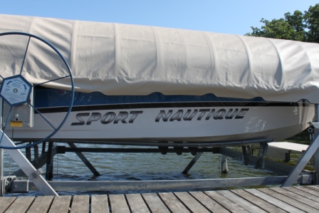

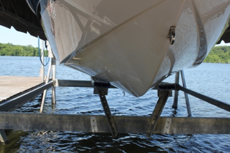

This is a pic of my boat on my lift last summer. It is a Vibo lift with solid aluminum bunks. The prob is the bunks do not twist to conform to the flat hull in rear of boat and vhull in front. I know I need to move the bunks wider but that will still mean either the front of back is sitter on an edge of bunk since they dont' twist. I've tried leaving them loose to see if the boat weight will twist them but it didn't work. My question is should I use a carpeted treated 2x6 as a bunk since that will twist to fit the hull. The thing I'm worried about is the hull comes in contact with the bunk about 18 inches in front of the front cross beam and i'm afraid this may break the 2x6 at this point. I also thought about an 18 inch carpeted 2x6 on each arm but the front of the hull does fit those as well un less I shim them out somehow.
What are other people using?
Should I be concerned about the setup the current way?
