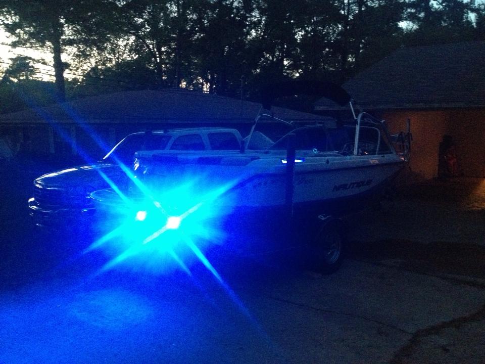

    Finally got my underwater lights installed and I LOVE 'em! Super easy install too!

      Thanks! I went with two Lumitec Seablaze 3s.

              The majority of the install time was measuring, remeasuring, and gathering the cajoñes to drill holes in my transom! All total, the actually drilling and running wires took maybe an hour.
              I used black 4200 sealant around the holes. Ran the wires to an unused switch on my dash panel (shower). While I was running wires, I replaced the courtesy lights with blue LEDs and added an LED strip inside the vents on either side of the boat. You can "kinda" see them in the pics. It looks even better at night!
              I'll take some closeup pics tomorrow. Thanks for the compliments!

                  Is it just 1 hole per light? How large of a hole is it?

                      4 holes per light. 1 at 1/2" for the wire and 3 others for the mounting screws about 3/16" if I Remeber. Here's a picture of mine mounted

                          Correct, 4 holes per light. I caught a good deal on eBay and got mine for $175 each.
