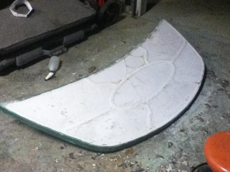

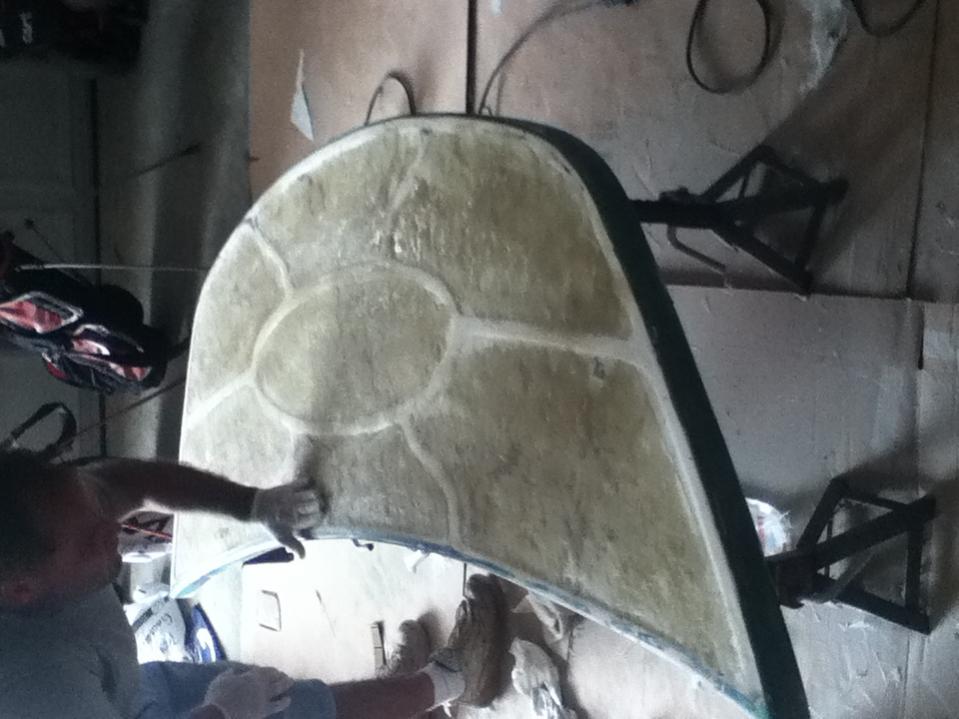

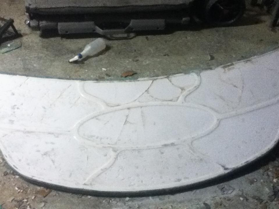

          She's is sanded and ready for Bondo and paint. Coming along nicely, after we paint it all that's left is Seadek and it will look brand new.
ID:	365860Click image for larger version
ID:	365861Click image for larger version
          We are painting it a glossy black (like a car) and then adding the teak over black seadek.

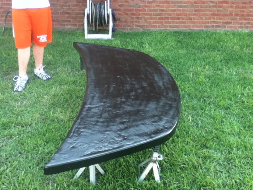

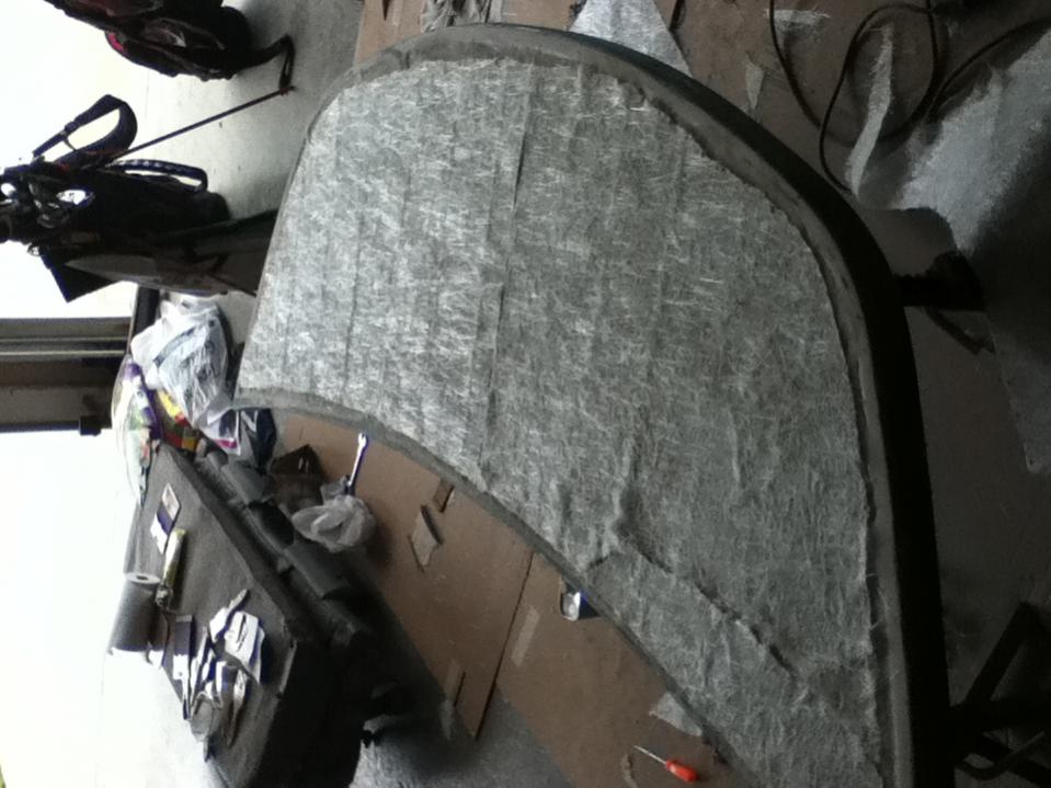

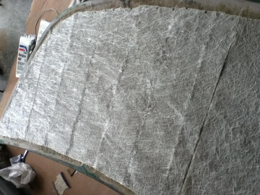

                      Ok, I have finished the restoration part of this little project. When I was re-fiberglassing I did: 1)Mat 2)Resin 3)Mat 4)Resin which turned out great. I then sanded (about 1000 times), one coat of primer, and two coats of paint.
                      First layer of fiberglass
                      Second Mat
ID:	366001Click image for larger version
                      Primed and Painted
ID:	366003Click image for larger version

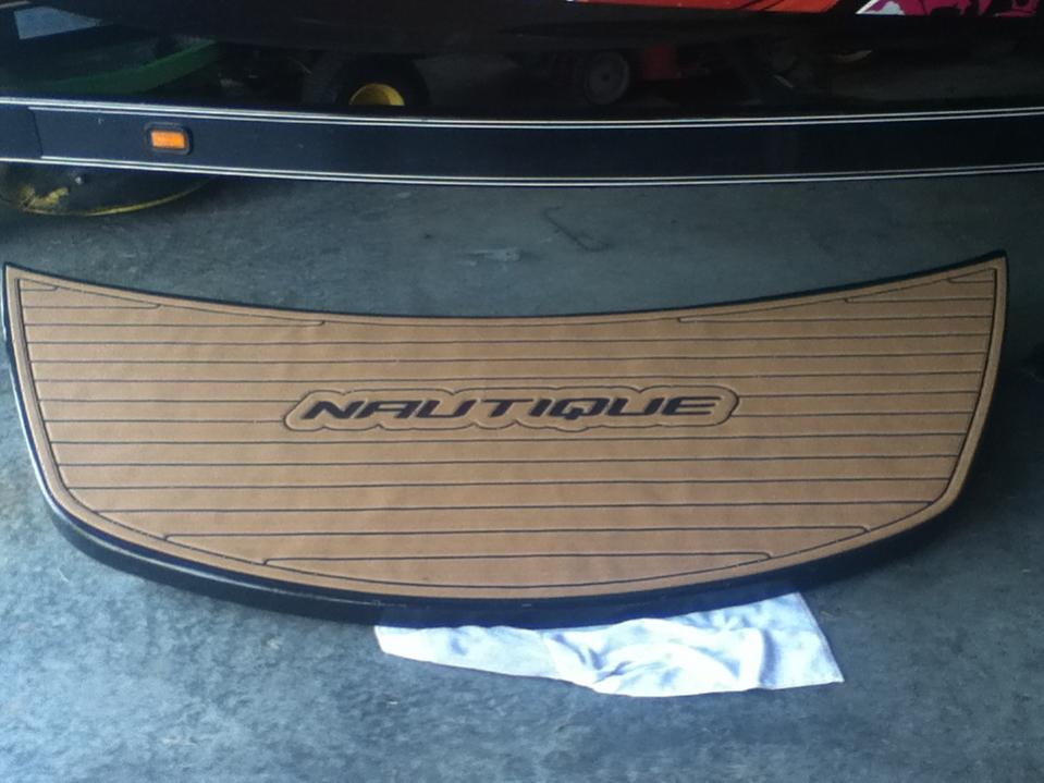

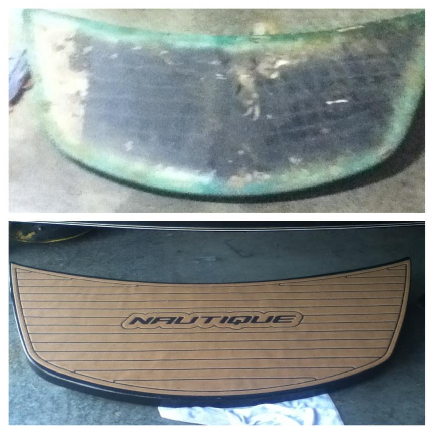

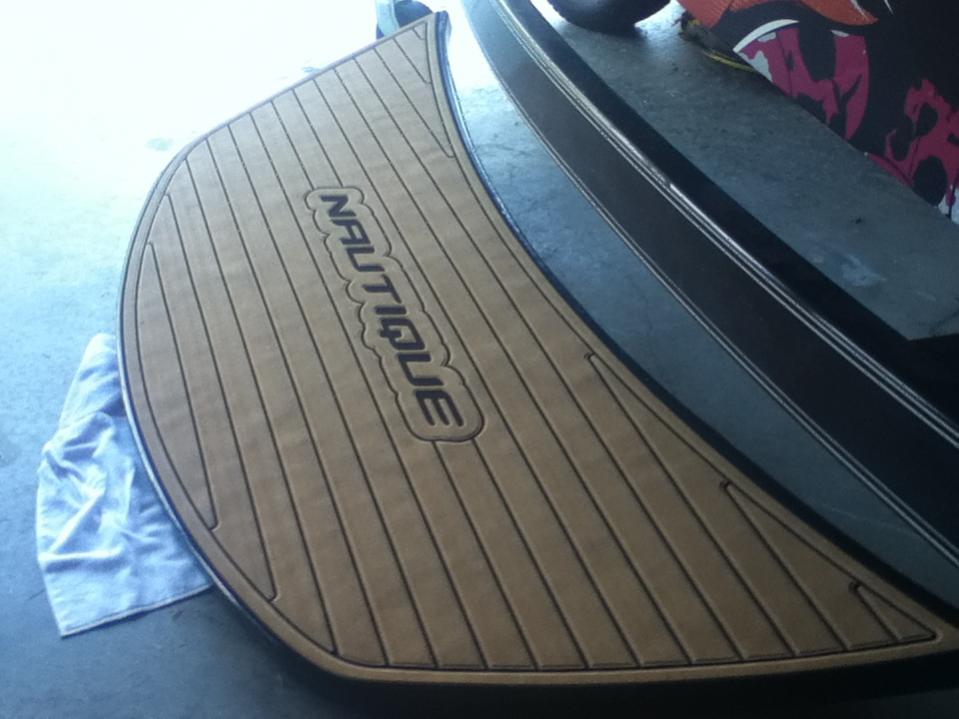

                            So after what felt like years of waiting...Seadek FINALY shipped my platform pad and I put it on. I have used it for one weekend now (~10-11 hours) and I am very pleased with this stuff. It looks fantastic, feels great on your feet, and is pretty durable. I have posted some pics below as well as one before and after pic.
ID:	366484Click image for larger version
ID:	366485Click image for larger version
ID:	366486Click image for larger version
