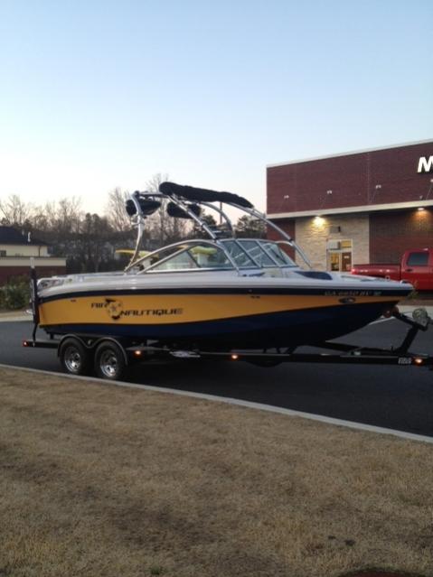

    3. How do I discern between the type of tower I have? I believe that it is a FCT 2 tower but appears different from others that I have seen as it does not have some of the flat bar supports etc. It is all round tube by design. I have attached a photo for reference.

      You have a Titan FCT2 on your boat the bimini is made by Tower Biminis . The short tubes in the back should have a full circle groove on the side that attaches to the tower . After they are inserted into the aluminum fitting they are retained by a pin that goes through the hole on the side. The push button side attaches to the rear bimini cross bar. Mine has a pylon at the rear lifting ring. I use Mobile 1 15w50 in my 210 change every 50 hours. The cooler that came with the boat fits under the passengers side dash storage. I dont use mine because it takes up too much room. Colman makes a short cooler that fit under the rear seat with slight modification to the lid. I carry two . I see you are in Cumming we have Nautique get togethers on Lanier a few times a year I hope you will join us . Give me a call it you have any more questions

                I have the same FCT2 Titan tower and Tower Biminis bimini...unlike NautiqueHunter, I don't have pins that hold the rear extensions in place on the tower side. The push button holds them in place on the bimini side. On the tower side, they fit as NH described, but are held in place by the tension on the bimini when the front pieces are set (with pins).

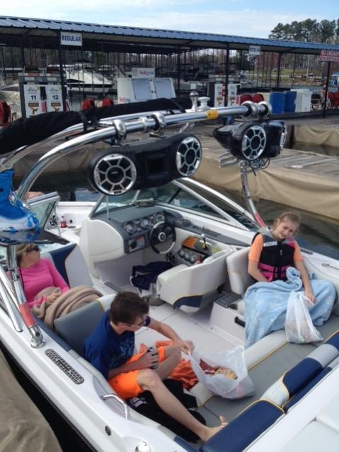

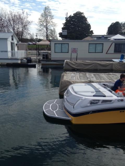

                  You cant use the original lids because they will not fit under the seat so I just used a piece of 1/2'' styrofoam cut to fit inside the cooler, works perfect. I never flip the seat but I doubt they would slide much on the carpet. Its just so convenient to not have to open anything or move peeps to get into the cooler. Here are some pics of the rear bimini bars.

                    Just an update: I ordered and received the short/ rear bimini struts from Tower Bimini and John was very helpful. The new tower inserts are stainless steel and appear way stronger than the orignal parts and much heavier and were reasonably priced.
