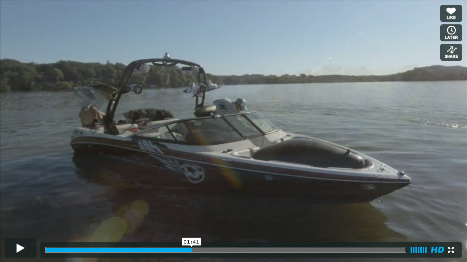

                      The 230 has been an awesome ride for us when we do about 60:40 rear to front ratio. We do 1100's in the rear, a 375 on the bow floor, and then an 1100 pound bow triangle on top. It works well for us, because no one ever sits up front. If there is only 2 or 3 of us we'll put an additional 2-450s on the midship cabin floor. We also have an extra 300 or so on the port side to keep the wake clean on both sides.
