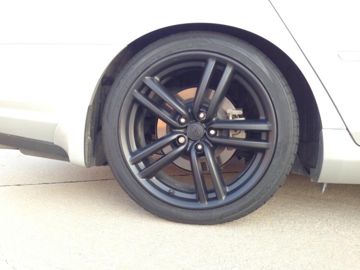

                            • rick230
                              • Aug 2011
                              • 24
                              • Texas
                              Originally posted by jrz1 View Post
                              Looks good. I've got to try this on something at some point.....
                              wheels on my sons car. He painted while on the car - wrapped plastic garbage bag around rotor and taped lugs... he completed all four in a couple hours
