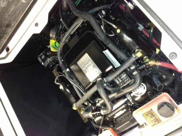

            You guys are one it! The XS stays as standard in the costal edition. The XR is painted black and has exhaust manifolds instead of stainless headers. Its 6k less than the XR and still makes the ponies so I don't see anyone opting for the 550 XS. XS must mean Extra Spensive!
            I think they need a Barefoot Nautique 210 with a 550 XR .
            Here she is
