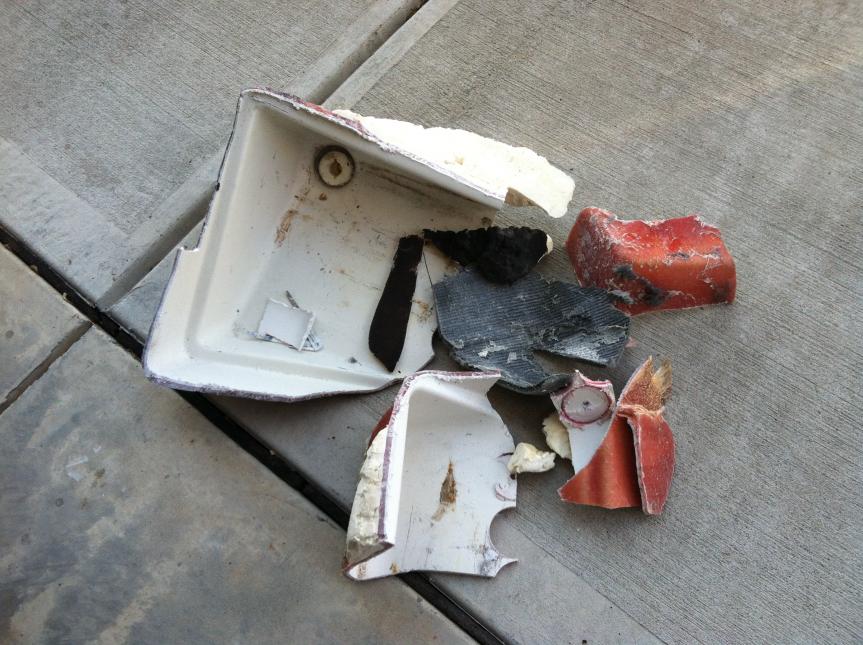

              Mine was partially carpeted on the front side. That was not a huge deal. The issue was the foam on the side of the cooler where the bow cushion goes. I had to pry it apart, and getting the corners cut. I was also going to bring it out through the kick panel but the PO installed a heater behind the kick panel and there wasn't enough room. So I had to cut it into sections.... FUN!!! Here is the leftovers....
