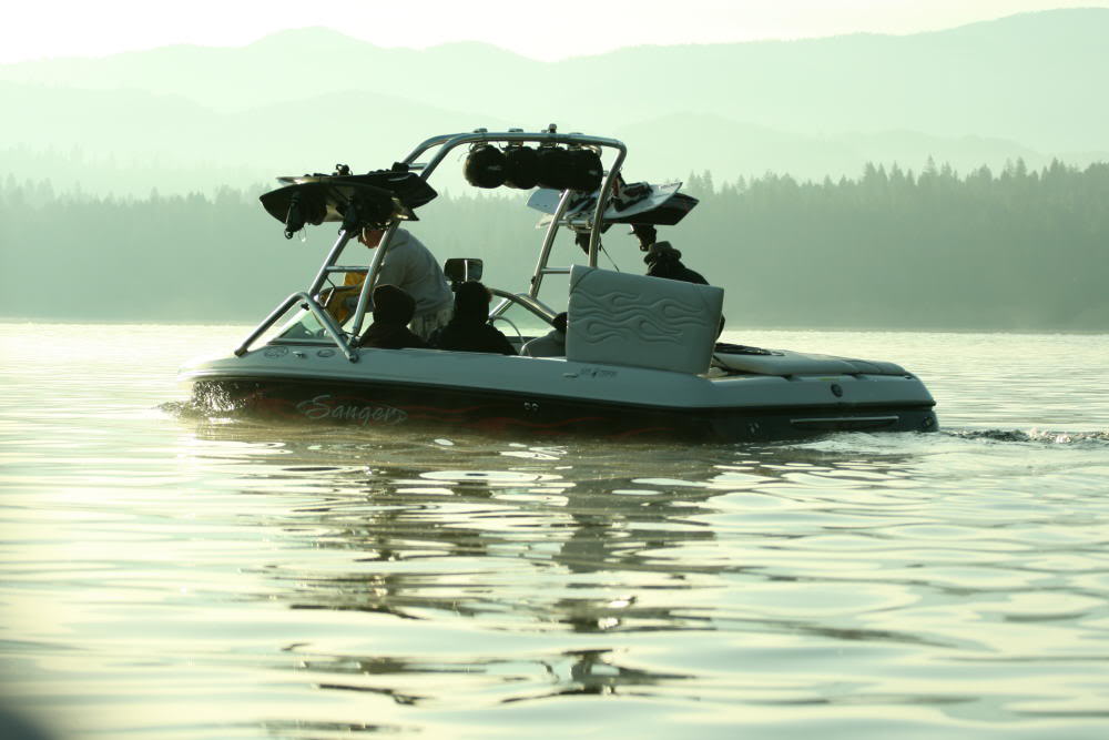

                        You know that bimini snap cover is on with the window shut for a reason on that star Reminds me of a pic I've seen of a sanger where the transom was so buried the swim platform was under water - by quite a bit. I'll see if I can dig that up.
                        • wakeboarder3780
                          • Jan 2013
                          • 66
                          • SC
                          I would be terrified of swamping the boat in these setups.
                            [ATTACH=CONFIG]20533[/ATTACH]
                            I agree, that looks nuts!
