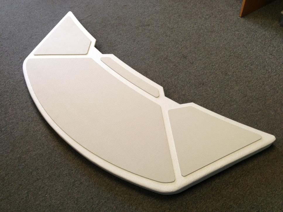

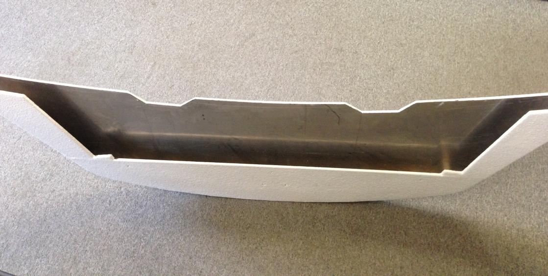

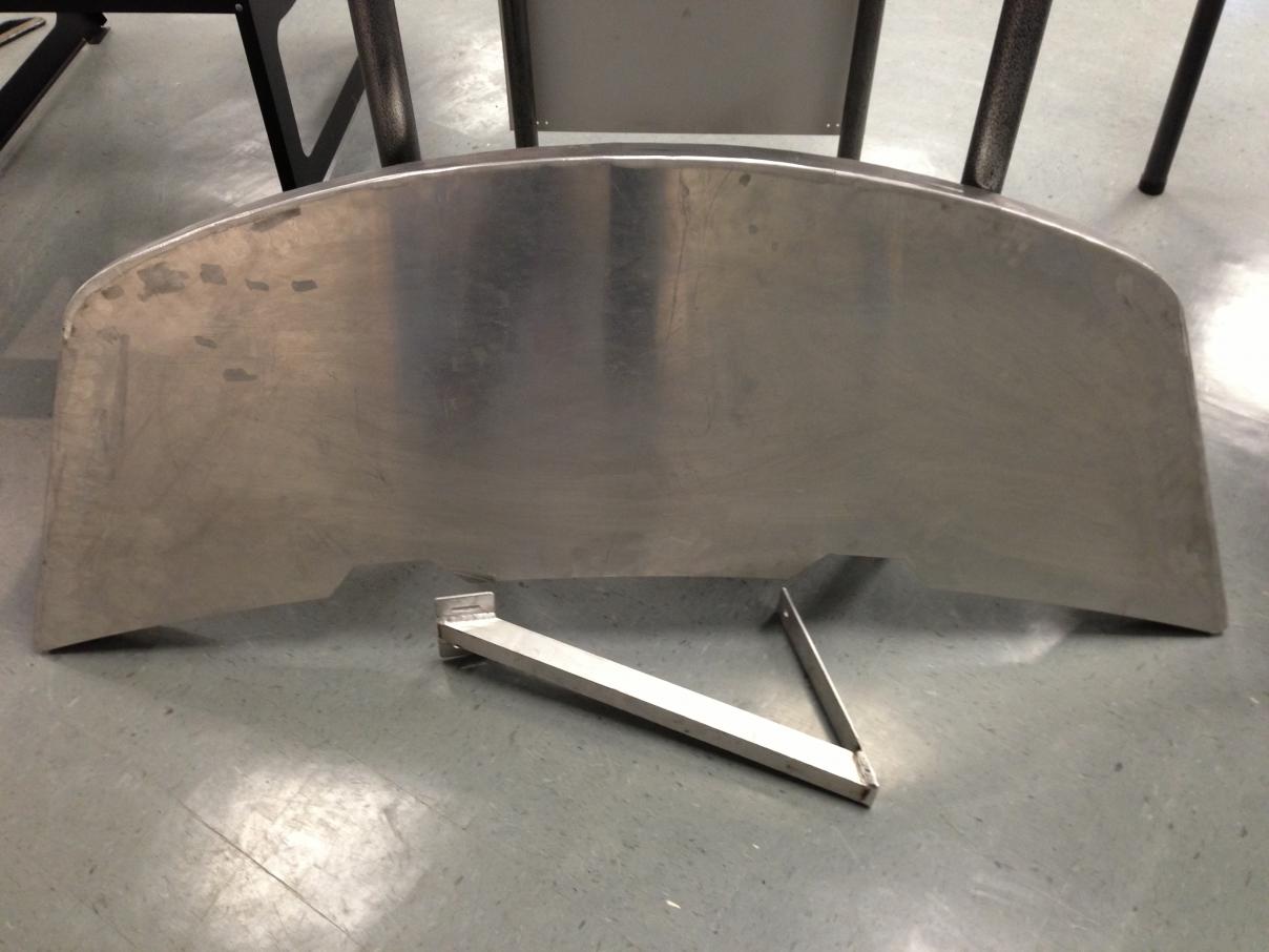

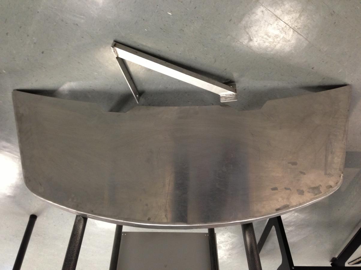

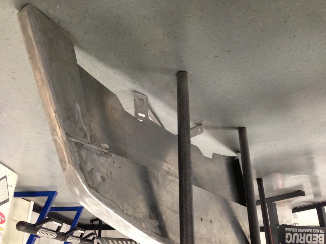

So not to ruin the value, and having access to a sheet metal shop, I have had an aluminum "sleeve" deck fabricated that measurements match my friends 2012 SAN 210. It is 26.5" deep vs my stock 17" deep deck. I plan on coating it white, then laying Seadek on it.
My worry now..before I complete the finish work...is this deeper deck going to put too much torque/load at the bracket mounts on the transom? I am visually comparing my new deck size to a 2003 composite that is deeper, while it appears a 2003 uses the same deck support brackets. This said....can anyone tell me the depth of their 2003 210 swim deck?
