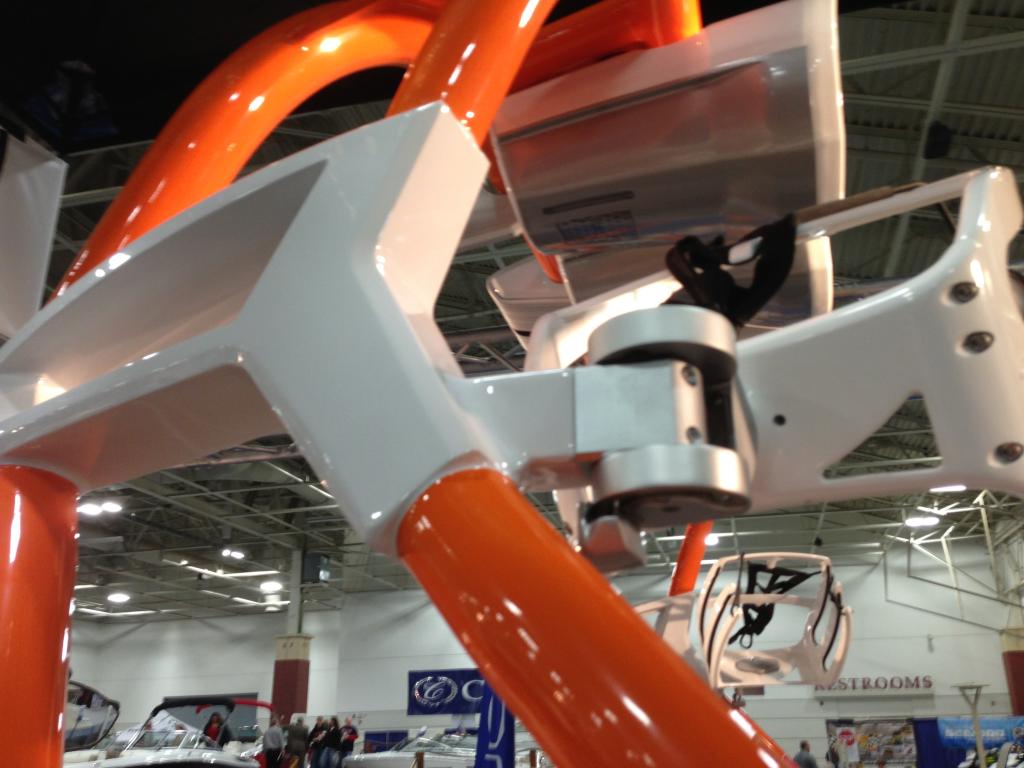

                Decided to make a 6 hour drive to see one of these to answer some questions for myself. The short answer is you *cannot* get 4 racks on this tower from the dealer (aftermarket may be another story but after seeing it in person I think it's going to get a little tight trying to get the other 2 racks on since the integrated racks are positioned smack dab in the middle of the tower).
                Essentially the rack is integrated into the bracket on the tower. Here is a picture that illustrates what I mean:
                As such the 2013's will not have the ability to have 4 racks from the dealer which I verified with the salesman showing me the boat. I do have to say there is a lot of storage in the rear lockers and under the observer seat, however under the normal seat bases there is average space. For my particular use case, the rear lockers get bags added immediately to enhance the wake even more (I personally don't invest this much in a boat without seeing exactly what it can do). The observer chair is where I store all the life jackets (you need a ton of life jackets to be legal if you ever have a lot of people in your boat) so that takes up a considerable amount of space.
                For my specific use case, I am frustrated that I can't get 4 racks. However, that being said, it was the ONLY downside I could find in the entire boat (and I am a very unbiased, critical reviewer when it comes to boats). There wasn't really much question in my mind before I went, the boat seemed amazing, seeing it in person just confirmed it. One thing I would mention is that the compartment that holds the batteries and pumps seems bigger in person than it did in videos - good thing. The pocket door wind dam is nice because then you aren't clunking around storing the separate wind dam - it just retracts into the driver side behind the dash - nice feature. The other thing I loved was having an integrated boat charger on the boat. I'm a little worried about how long the charger will last since it will constantly be in a marine environment (moisture, vibration / shock) however even if I had to replace it every couple years, the simple ease of use of being able to take a regular exension cord and stuff it in a built in receptacle instead of lugging chargers around is a big win IMO.
                The only other thing I'd mention to at least warn other people that like to put bags in the lockers. The engine walls *will* need stout reinforcement. This is true in my malibu as well because running 1100's in the rear typically require a fair amount of reinforcement but I'd say this engine wall divider is even softer than on the bu's. I think you'd have to get crafty about how to do the reinforcement but it can definitely be done, just noteworthy for other folks that push their boats limits.
                All this to say that I am legitimately frustrated that I can't have 4 racks and I really REALLY hope CC / nautique addresses this in the near future because its the only variable that sets them behind the competition (both bu and mc support quad racks). Here's hoping 2014 comes with quads!

                  3780, I would agree with your assesment re: boards, I have a buddy who usually brings 3 w/him! The stock racks are Roswells, and they also supply the towers, so it's worth a call to them to determine if they have some aftermarket offerings. They do make a clamp which supports those swivels/racks. Also worth checking out Samson (sp?) Sports up in WA state, they have some really nice swivels and racks.
                  I like the z5, so that would be my solution...

                      My Communication with Roswell, sounds like it wouldn't be possible to get 2 more spinners on it
                      Me: Hey folks,
                      Been looking at the nautique g23 recently and I have to say I'm very impressed with the boat. I only had one gripe about the entire boat and that was the fact that the dealer was telling me it wasn't possible to order the boat with 4 racks on it. I heard from a fellow forum member (planetnautique) that you guys make the towers and racks for this boat. If that's true, do you have any idea of it's possible to add 2 racks aftermarket to the tower? The problem I see is that the current integrated racks are smack dab in the middle of the tower so I think it would be tough to squeeze them in above or below. What are your thoughts on this?
                      Rep: we are making the accessories but not this specific tower for Nautique. The first question to ask you in regard of the rack is would it need to swivel ?
                      Thanks and have a GREAT DAY!
                      Me: Ideally it would swivel and look as close to stock as possible. This is what the current ones look like up close:
                      Rep: To be honest it would be very difficult for it to match the factory due to the tower shape and placement of factory racks. Sorry. We could probably add a set of static racks somewhere else on the tower but would need to test fit.

                        I think your just going to have I make due with another set of static racks. Hopefully Roswell could come up with something that looks close to factory.

                          Malibus have places for 4, but not sure if they can all be swivels. I could see a way to do it on a G style tower, but I think you'd have to omit the stock mount swivel and go higher and lower...

                            From looking at pics it appears that the factory swivel racks are just bolted onto the end of that center piece and could easily be removed. I would think that roswell could manufacture some normal/traditional tower clamps that would allow you to relocate a factory rack above and below that center piece.

                              Roswell could do it, but it's not that straight forward. They would have to develop two different clamps for the lower and upper positions, and because the tower is not that tall, the boards would probably interfere with the tower speakers. Probably a fixed rack up top would cover you.
