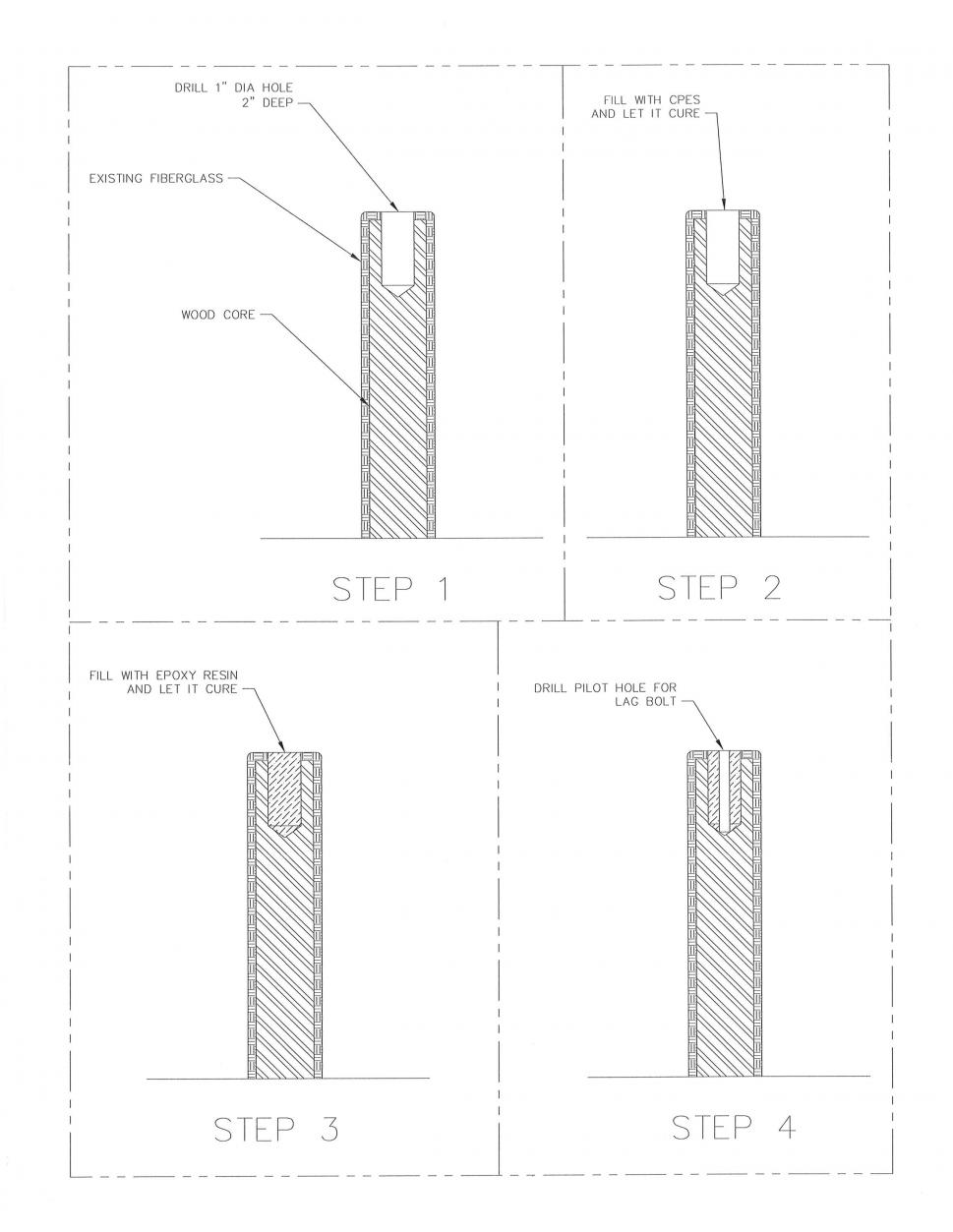

Anyone interested in engine mount (stringer) repair with CPES? I just finished mine.
    This system worked pretty good for engine mounting lag bolts that wont hold from surrounding stringer rot.

      Actually, I chased the mounting holes with a 1" drill to see how bad the rot propagated from the bolt holes. Surprisingly, the wood was very solid. My previous boat had a simular issue, but like you said, it was pretty far gone after I dug into it. That one got new stringers.
      I don't have any pictures that would help to see how it was done. But I do have some nice illustrations on how to do it. This is how I repaired the horizontal surfaces:
Name:	horizontal surfaces.jpg

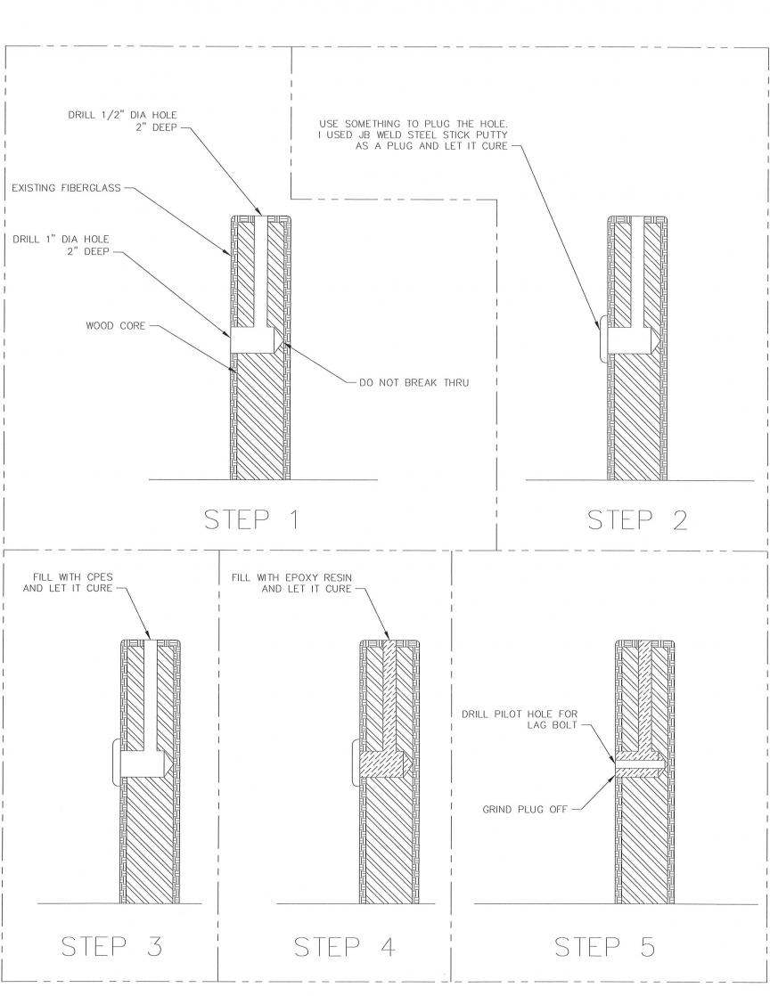

      This is how I repaired the vertical surfaces:

        You may have done more damage than good. Just sayin'. That effectively weakens what is left of the stringers around the area you drilled, leaving not much structure to support everything. Guess time will tell.

          CPES stands for Clear Penetrating Epoxy Solvent. After the 1” hole is drilled, CPES is addedto the hole. Because wood isporous, the CPES soaks into the woodfilling the voids between the wood fibers with epoxy. I’m guessing it penetrates a good ½” or morearound the 1” drilled hole. After abouttwo weeks the solvents evaporate and the epoxy cures. The treated area turns into petrified wood(even stronger than fresh wood). Afterthe hole is filled with epoxy resin, the resin sticks to the treated wood withan extremely strong bond (epoxy to epoxy).
          I spent many hours researching this product before usingit. It’s pretty impressive. It’s also very expensive. I’m not disagreeing that stringer replacementis the best route. I don’t agree thatthis is only a band aid or that it will make the stringers weaker.
