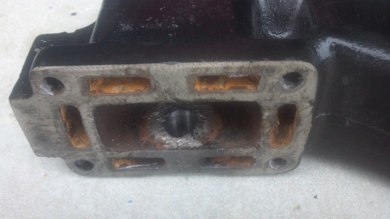

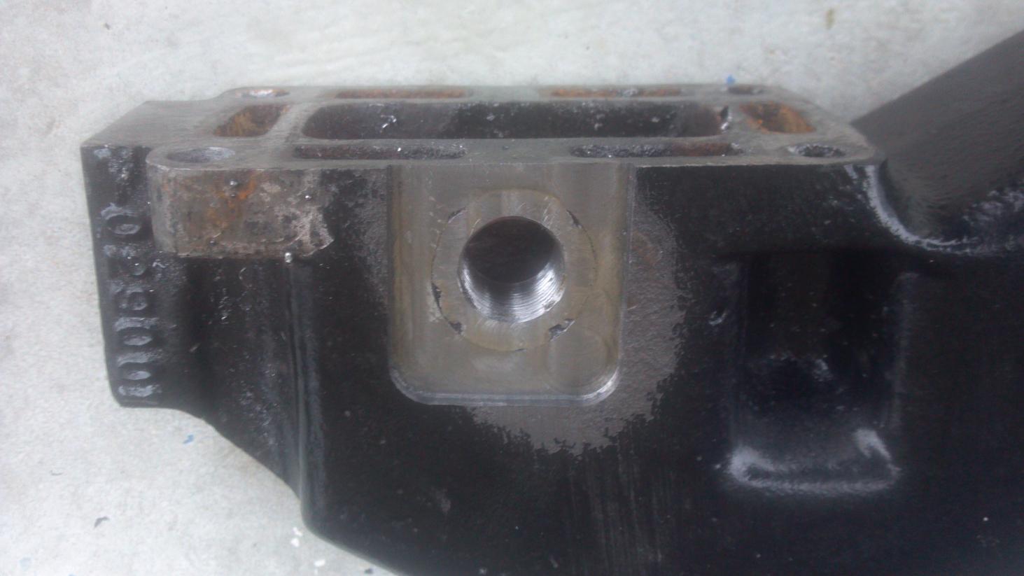

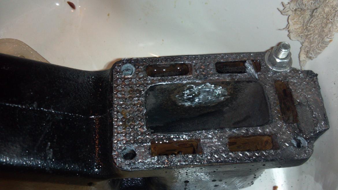

      I think I see whats going on here... you cut a hole (~1" diam) that went through the water jacket to the dry part of the riser, then filled it with some stock, welded it in, then drilled and tapped that stock?
      Pretty cool.
      1990 Ski Nautique
      NWCT
      • Mamigacz
        • Oct 2012
        • 118
        • Sheboygan Falls, WI
        • 1986 Ski Centurion concourse skier
        #33
        Yep, that is exactly what I did.
