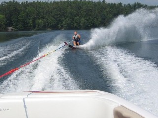

                  The difference between the TSC1 and TSC2/3 is more than just perception... note how "undefined" the rooster is in this pic... TSC2, 15off, ~30mph. TSC1 has a slightly more defined 3-prong rooster. Not nearly as defined as the NWZ hull though... and still a world class slalom wake. I cant tell the difference between a TSC2 and TSC3 (gate down), either visually, or behind the boat... which makes sense, as they are supposed to be equivalent.

                    Maybe you can see the difference in the -15 rooster, but can it be felt? Maybe I'm not the best resource afterall, as I haven't skied -15 in quite a while (or at 30 for that matter). I can tell you that our TSC 3 boats wakes looked taller than our all of our Prostars visually, but the additional height was nothing more than foam bubble bath.

                      I agree. TSC rooster tail is a soft bubble bath. Here it is at 32 mph, 34 mph, and 36 mph.
